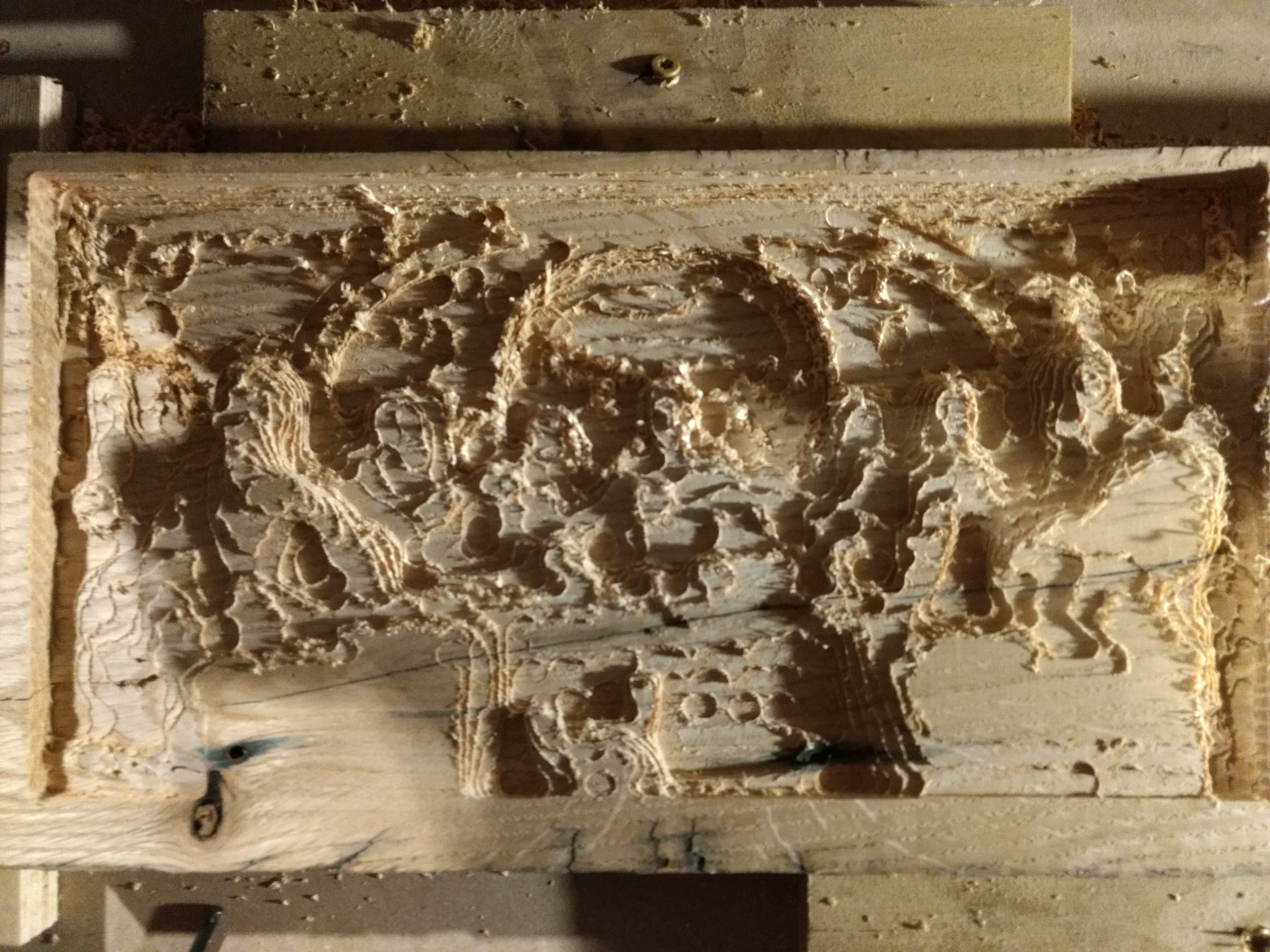

Step one of the profile carving. I will be amazed if this actually turns out! Will post the results. Good, bad, or ugly.
Well, I guess it’s good, bad and ugly. Set my material thickness wrong, so it didn’t cut deep enough for this. I guess I can make it look okay with a lot of tedious sanding.

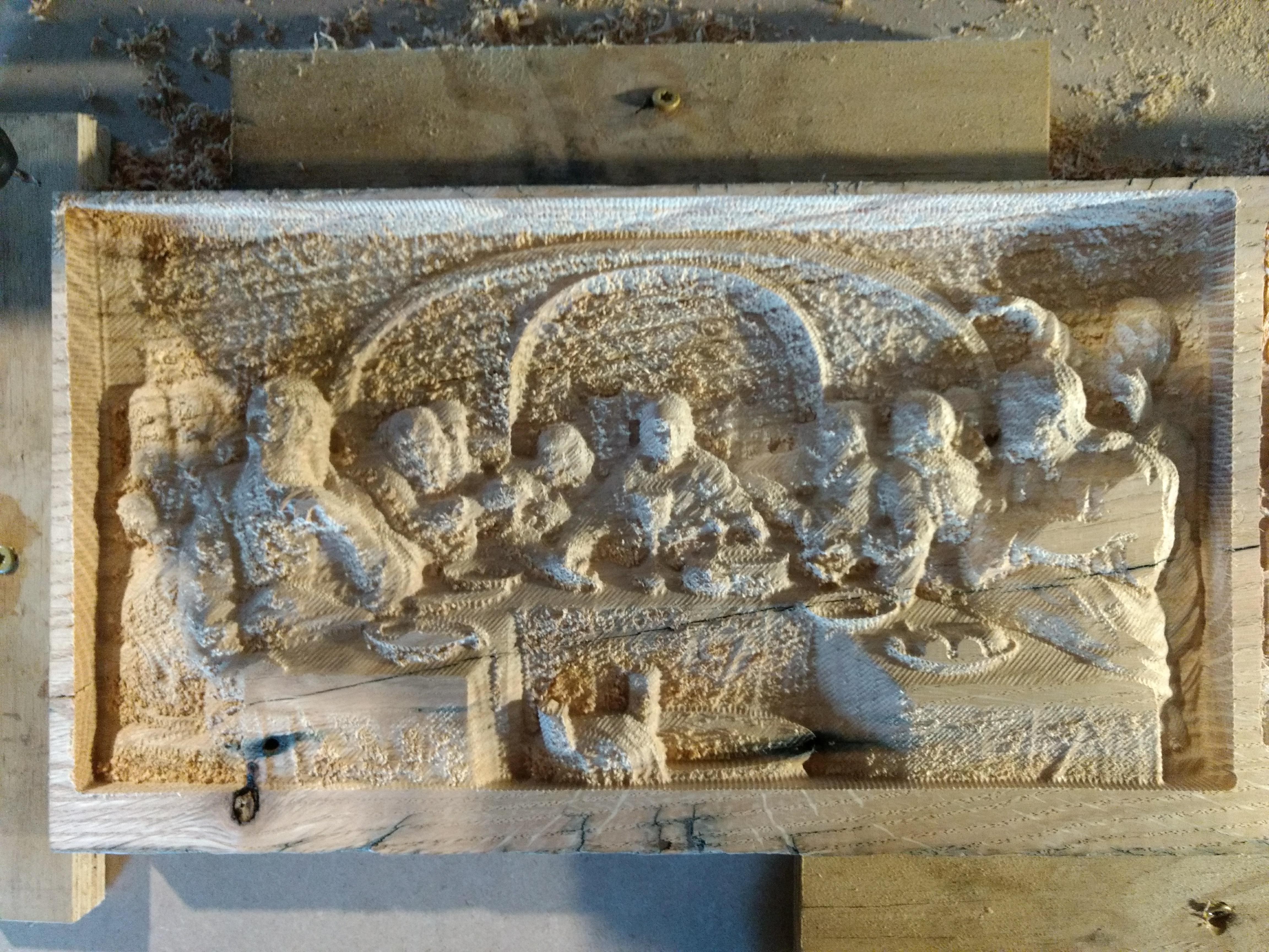

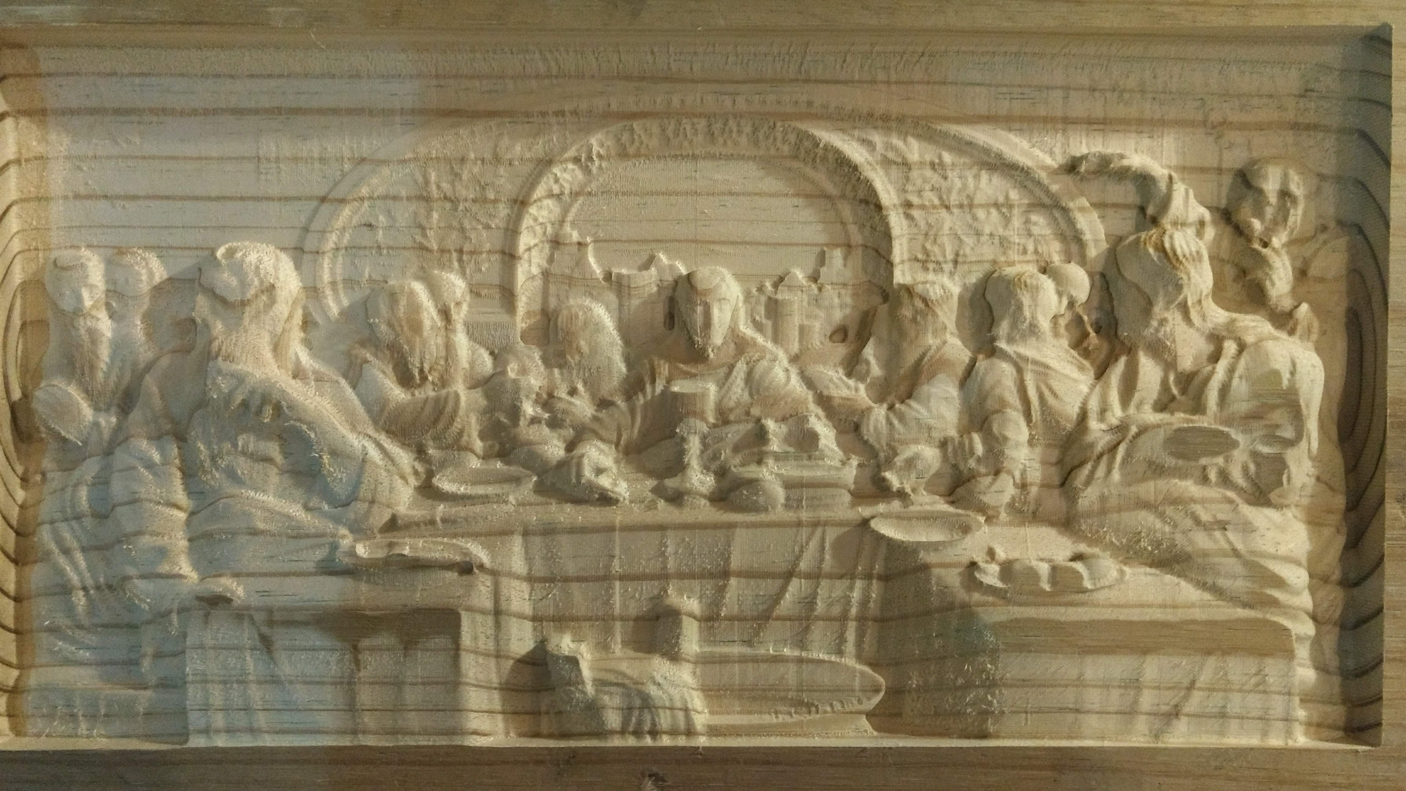

I have to say that this turned out a little better. .25" upcut end mill roughing. 40% step over .125" ball nose finish. Single pass along the Y axis. 10% step over.

@Hobby_Fab Thanks for the compliment and advice. I do have that option within Cut3D, but chose not to add the 8 ADDITIONAL HOURS to the job. I have too many more projects for that kind of nonsense, lol.
This one actually looks better in person. I guess if you are not viewing it from different angles, it fails to show all of the other details. I will have others to add soon.
I am still missing something. I think I need to start the cut just below the surface or something. I shouldn’t have had the flat surfaces, like the hands. There should have been more details, like maybe fingers! It shows them in the software, when I simulate the finish cut.

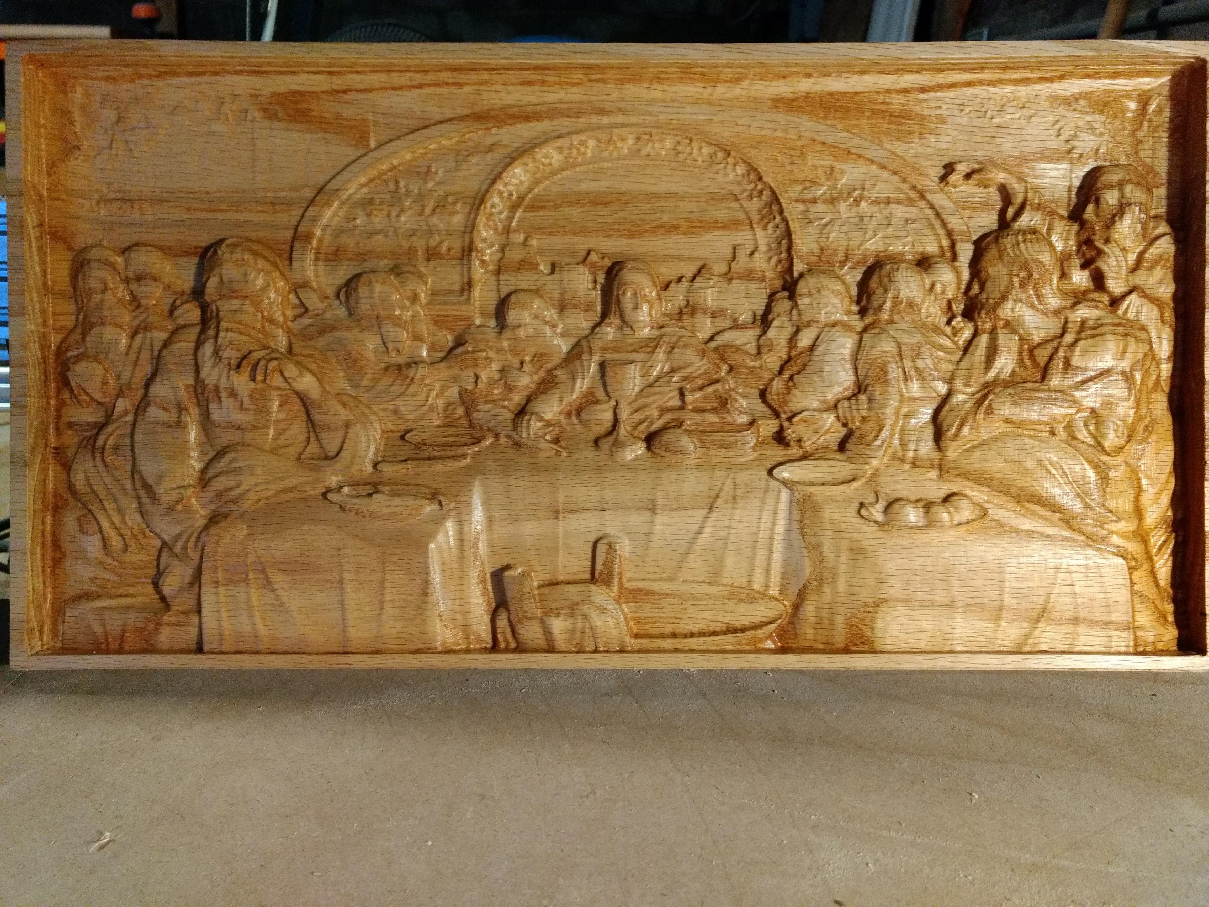

I thought I should close this post with the last “Last Supper” I did. This post is the very first thing I tried with my new machine. I told a few people what I was going to carve with it, and they all asked the same question. "Why would you try something so difficult for your first attempt? … I just answered, Because I should be able to.
It was a predetermined goal I had set for myself. I ran the code and it turned out a bit unlike how I imagined it. I did a lot of reading on other posts and forums, and I realized some mistakes I made with cut settings. I read more posts and realized my feed speeds needed adjusted, my step over amount was wrong.
There are many variables that come into play when it comes to getting that perfect result that everyone is looking for. Patience, the willingness to learn, and the determination to achieve your goals are some key factors to getting those results. Every machine is going to perform different, and all depend on the user to figure out what each one needs to perform at it’s best.
Try not to get frustrated with it, and don’t be afraid to try different things until you get it right. It will be worth it in the end, and it will give you a deep sense of satisfaction knowing that YOU did what you set out to do!
Is this last carving perfect? Nope. Is it better than the first attempt? I think so. Can it be made better? Absolutely! I will keep on reading and learning until there is nothing left to learn.
