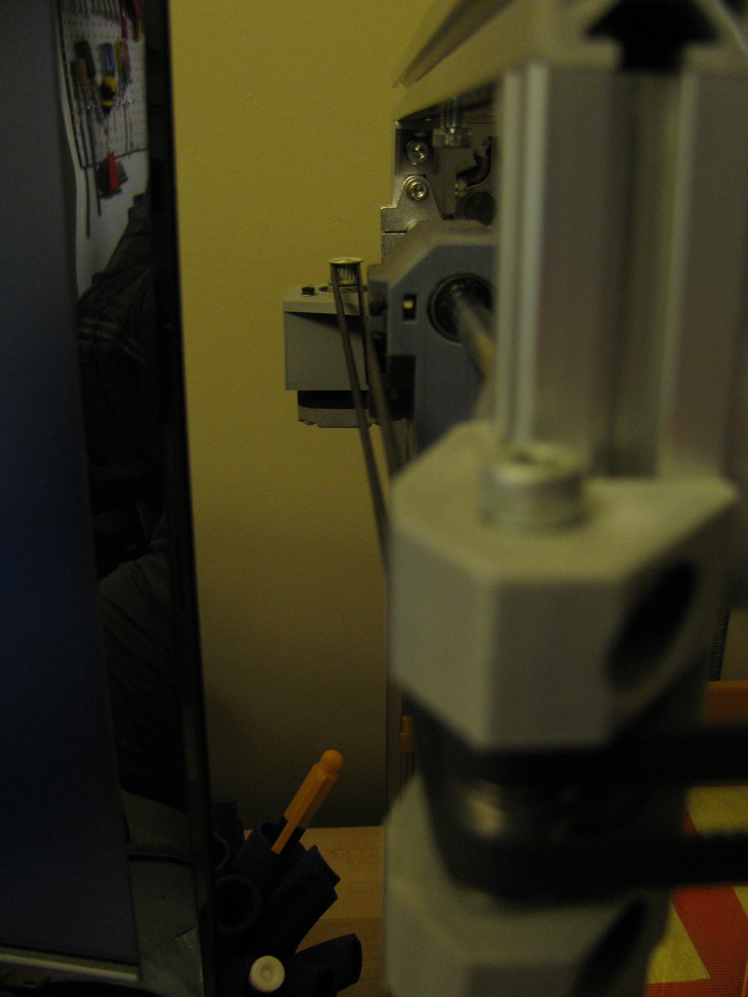

Stephanie S This is what I'm running now in my CoreXY,
@Stephanie_A This is what I’m running now in my CoreXY, it’s been working fine for over a year. Before that, I had the Y carriage idlers at the same height and the belts crossing at the front of the bot, as is shown in @Daniel_Newman 's Flickr: https://www.flickr.com/photos/d-newman/sets/72157645313526624/
After trying various things, my opinion is that people worry too much about CoreXY belt arrangements, you can do some weird-looking stuff and still have it work perfectly. Just gotta make sure all the belt runs through moving idlers are parallel/perpendicular and the rest of it is just details.
And yes, this printer is long overdue for some upgrade work, it’s kind of limping along with periodic PLA part failures (HATE PLA ARGH…) and I’ve been too busy working on my much-cooler printer designs to do anything with this one. It just works too well to take it apart for a rebuild.
