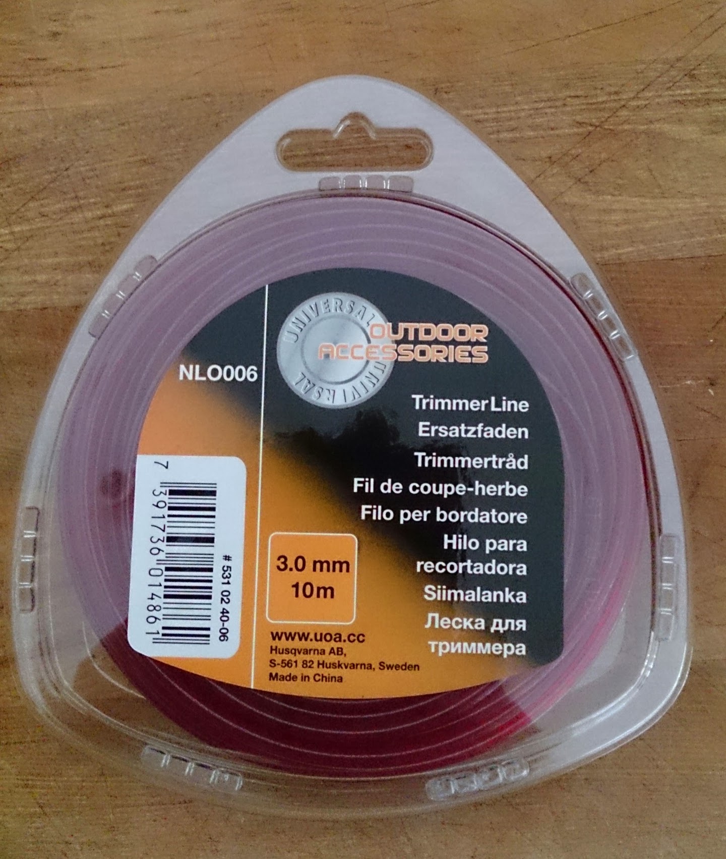

Stephanie Shaltes This is the trimmer line I've been having some success printing with.
@Stephanie_A This is the trimmer line I’ve been having some success printing with. International brand so you may find it in the states. I’m baking mine at 60 degrees for a couple of hours to remove any moisture.
Beware of the fumes when extruding. Nylon fumes are not exactly healthy.
Update: Seems it isn’t that dangerous. I would still be careful, but extruding Nylon doesn’t seem to cause much problems according to http://m.instructables.com/id/Is-3D-Printing-Safe-or-DIY-Testing-for-HCN-from-/
Due diligence for the win! :slight_smile: Love when people link to their sources.
@Matt_Kraemer1 Placemakers or Bunnings… If you can’t find any, I can mail you some. Been looking for the larger rolls as it’s a buck a metre for this length.
