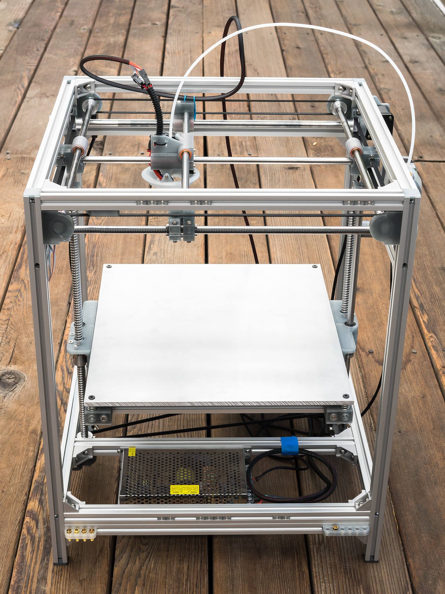

Still a lot of work to do, but it’s up and running. I accidentally mounted the extruder carriage backwards, and cracked a few of the bearing holders, so I have to rebuild the top. Other than that, the printer assembly was much easier than I expected. The ball screws seem to be working fine, and the graphite bushings seem to be working too, though I don’t have anything to compare them too. I did have some problems with binding when placing two bushings in a row, but printing a single 60mm NinjaFlex sleeve to hold both together seems to have fixed it.
The silicone heater arrived today, so that will be going in next, and I’m considering converting to direct drive bondtech at some point.

Thanks Alex! I’ll let you know if I need anything. I just went with a rectangular plate for the heatspreader to keep it simple. I also made it 16" long to avoid having to cut glass plates (though I’m kind of regretting that last bit after trying out some nicer glass cutting tools last weekend at the maker faire).

@Eric_LeFort I like the color too, but I would recommend against using it for at least some of the printer parts (probably applies to clear ABS in general). It seems too brittle for the bearing mounts and the rod holders, I’m going to have to reprint them since some of them have started to crack.
The problem with the parts cracking may be specific to the hatchbox transparent ABS I’m using, I didn’t mean to imply that your PLA parts are likely to have the same problem. I’ve printed parts before that were under tension with blue hatchbox abs and it ended up cracking months later (if I had remembered that when I started printing the parts, I probably would have chosen a different filament). The same part in semi-transparent PLA lost its springiness over time, but did not crack. Still, an spare set of parts is good to have (though a spare printer is even better

I made my bed out of a 1/4 inch sheet of 360mm x 16in aluminum. I only went with 16" because 12x16" is a common size for precut glass in the states, If i built another printer from scratch, I’d probably make it 360x360. I went with 1/4" since I thought it was more likely to be flat - it wasn’t (I got my aluminum cut at a local scrap yard). It was easy to sand it flat enough for glass though. I was also hoping the thicker aluminum would be less likely to change height with temperature (don’t know if it made any difference there).
If you’re building a heavy bed with ball screws be aware of the weight, if you make it too heavy, it’ll move on it’s own. In my case I can probably add about 4-5kg to the bed before it’ll drop on its own when powered off.

Other than what was already discussed previously (cross bars, bed size, ball screw milling), I can’t think of any significant things I wish I had done differently, but I’m still working on it. I like having max limit switches and I probably should have added those earlier. A lot of the t-nuts from RobotDigg needed to be deburred to fit, I should have ordered extras, would have saved a lot of filing. And next time I’ll probably pay Misumi to do the tapping for me.

My setup is a bit different with the 10mm rods, but here’s what I tried. I first tried putting sleeves on each bushing, but couldn’t get that to work. I then tried putting the two bushings in a single 60mm sleeve and that worked without having to anything more than a rough alignment. I also trimmed some holes in the sleeves where the rods cross (my bushings are 14mm in diameter so there isn’t any clearance for NinjaFlex where they cross), shouldn’t be an issue with the RobotDigg bushings though.
My current extruder is larger, and I initially had problems with binding now that the bushings are separated. I ended up using shorter 10mm NinjaFlex rings on the outside of the bushings so it isn’t as constrained. Using the shorter NinjaFlex rings makes it more like the Ultibots self-aligning bushing setup.
I did try printing a PolyFlex bushing sleeve before I used NinjaFlex, but it seemed too stiff. My sleeves are about 1mm thick though, a 2mm thick sleeve could be made softer by printing with less infill / shells. If you use a short bowden tube, the bondtech extruder, and print really slowly (5-10mm/sec), it will probably work well enough to print out some bushing sleeves in NinjaFlex.
