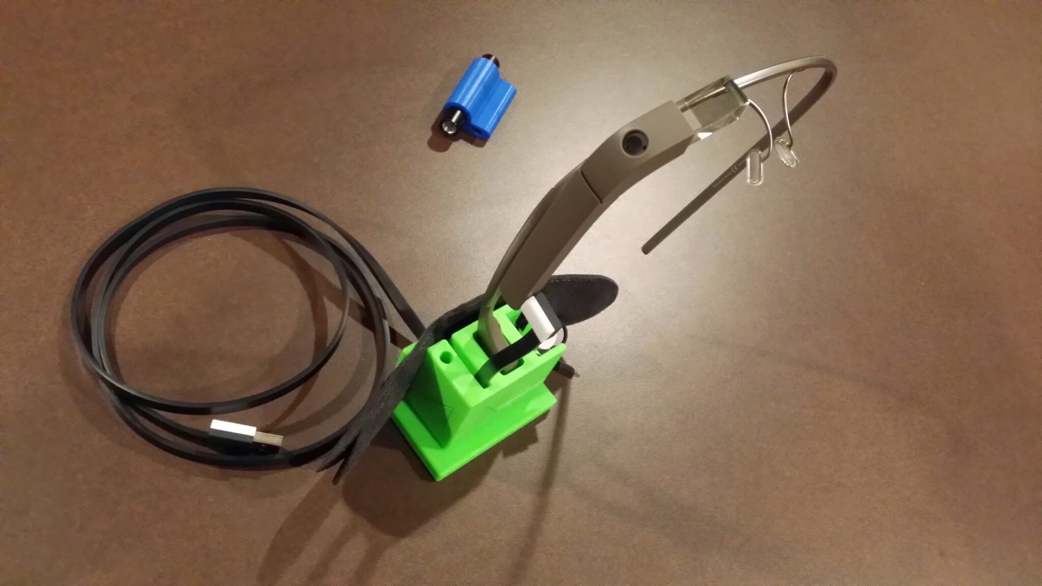

Still a work in process...  Originally shared by Ryan Matthews Here are some post
Still a work in process…
Here are some post print shots of the base. So far everything fits fine however I’m going to change the top near the inside USB cable track to make slotting in the cable easier. I was shooting to create a minimal material base and that it is (printed in under 3hrs for both pieces). I will try a denser in fill print 1st but I may want to add some girth for chambers so that you can fill it with coins to give it plenty of weight. Not sure yet, will play around with it. Regardless as I get closer to a final version I will slow the print down and drop to .1mm layer height to get better resolution.
Any observations you can make from the pics or features you would want for your Glass in a vertical base??
