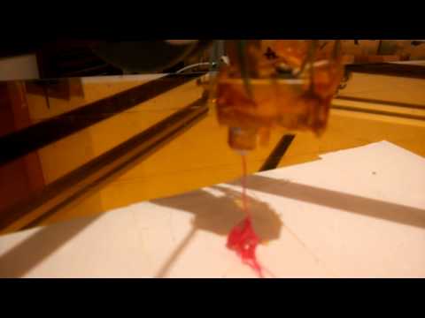

Still don’t know how I will mount #saintflint to my #BigQR1000 frame but I am looking forward to print with this combo with #tinyhe. Thanks @shauki for your mentoring ant sponsoring ![]()
