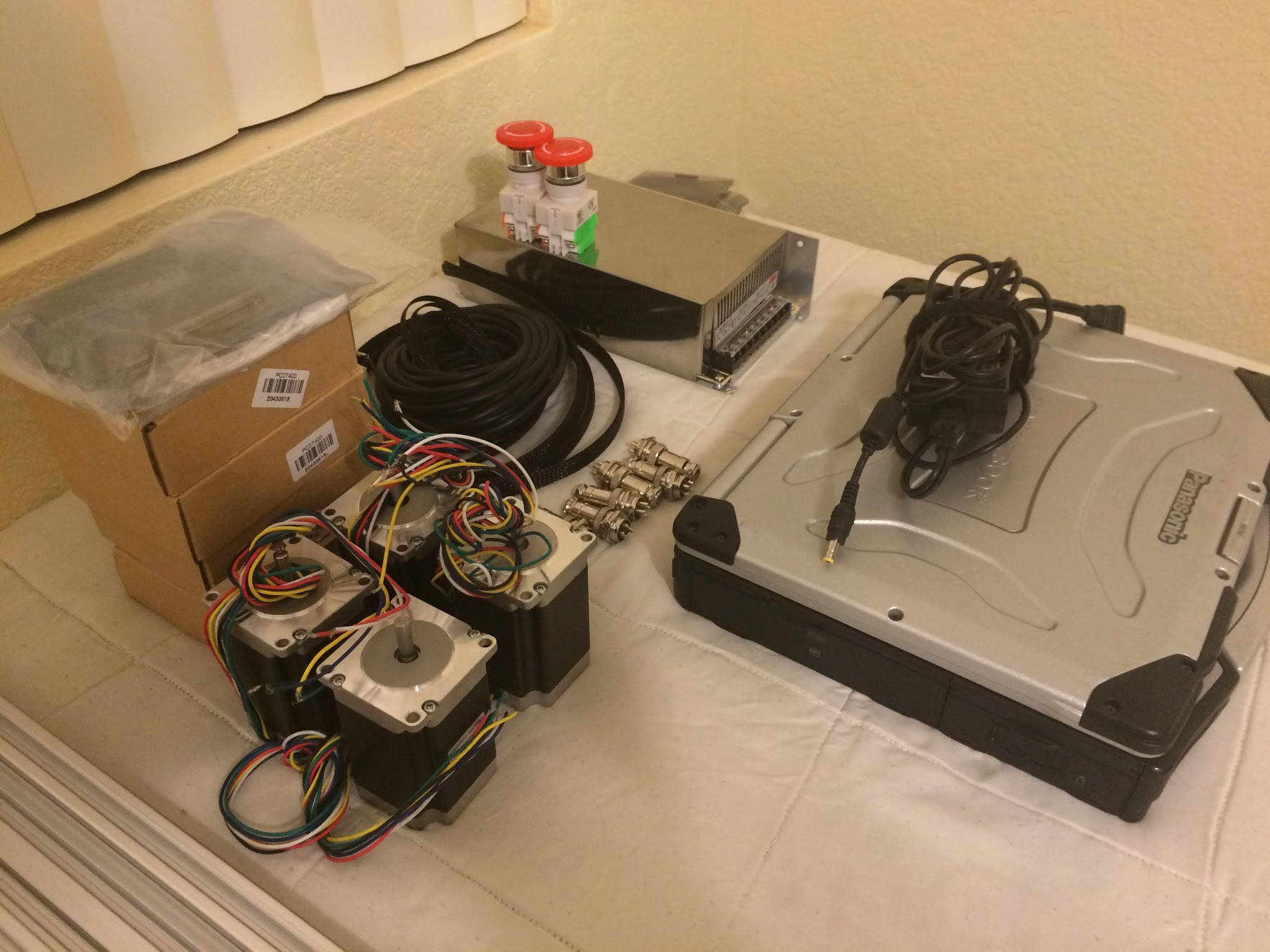

Still Gathering the necessities, but, just received my black Friday order and wanted to share. Going for C-Beam R7 build. Very excited :) Going to start getting the electronics sorted this week.
The motors seem quite large.
sweet! My V rails from cyber monday just sent 2 days ago.
motors were these -
http://www.circuitspecialists.com/nema_23_stepping_motor_57bygh405a-d.html
6-wire - I’m curious what motor driver board you’re planning to use for them?
@Jace_Richardson I believe the 2 extra wires are center traps and can be ignored (left unconnected) for 4 quite drivers.
As Kevin said, two wires are ignored. Only four connections to controller.
