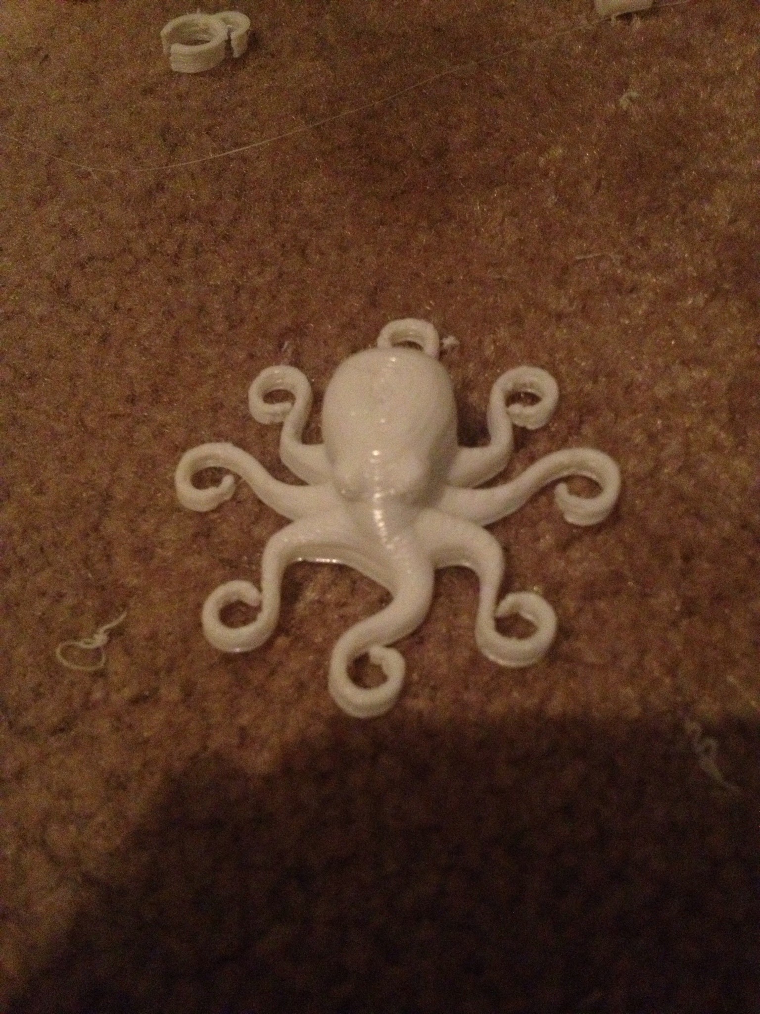

Still having issues with the top of these and other hollow prints dipping but
Still having issues with the top of these and other hollow prints dipping but the quality is getting better :slight_smile:
Use a bit of infill - works a treat on these smaller objects - plus adds a bit to the layer time so it cools a but more.
True :), they come out pretty well.
I’ve seen it done well hollow too and thought it’d be a nice challenge to try it out myself.
Why hollow? Extra top layers would help.
Soz I meant normal infill, I’d set top infill in slic3r but somewhere in between thay and printrun those layers didn’t print properly.
I managed to get better results with repetier though :slight_smile:
