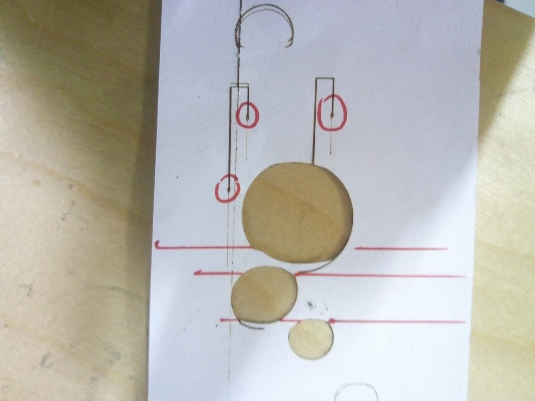

Hi ! It doesn’t seem to be a reflection problem anymore, I managed to coincide both up and down spot in the center of the 2nd mirror (i didn’t know that i could move the mirror to the right or th e left by moving the whole support so the two spots coincided at the extreme right of the mirror, thats probably what caused the reflection, but i still have trouble to find out what change the shape, it doesn’t seems to be a belt tension problem has i changed it and the problem doesn’t disappear, but i noticed some place on the y axis where the head seems to block (see picture) does it give you any sign to find where the problem is from ? Thank you ^^
The lines are where it seems to ‘block’ and i circled some spots on the rectangle cause it’s easier to see them on straight lines, those spots are where the laser blocks, it’s like if the machine has to make a really little loop (half a millimeter) and it shifts the whole drawing

Reading back through your posts this machine has had lots of mechanical problems so my guess is that the drive system still has something wrong with it. Why the laser comes on and off seems to be a separate problem. Lets see if we can rationalize the drive system first. My guess is that something in the drive is slipping.

It looks to me like the X axis is working correctly.
As the head makes the Y down move it whistles, moves and then gets a small X offset that is then corrected near the end of the upward Y stroke.

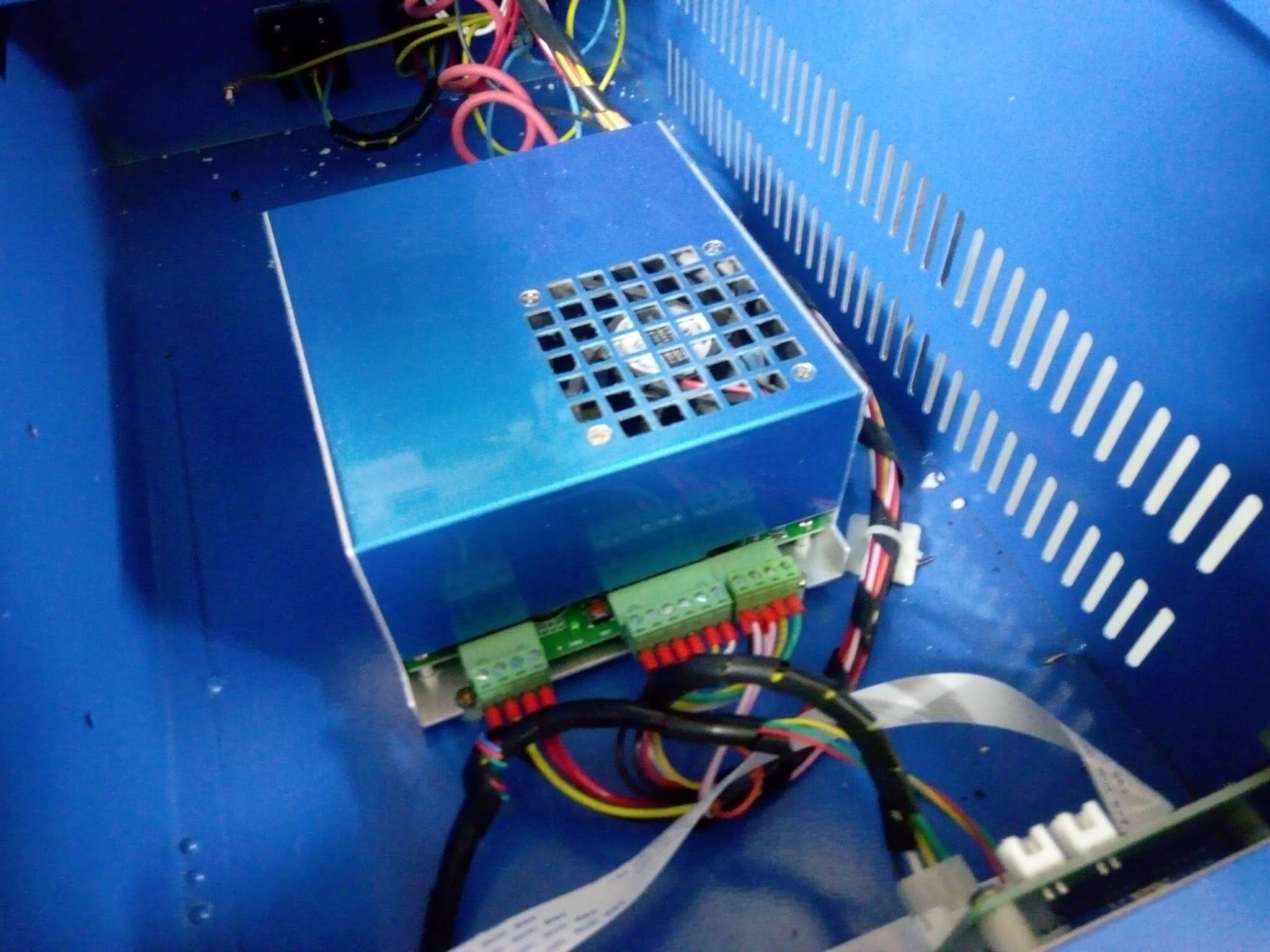

And this is where I think the noise come from, it seems to happens when the DEL lights on (so when the laser is working it’s logic…)

So here is a possibility to consider:
…The Laser Power Supply (LPS) is arcing internally when the laser starts up.
…This arc is creating electrical noise that is causing movement errors in the controller …
Try this at night:
…open the right cabinet and with the lights in the room off and the cabinet open, run the job.
See if there is arcing (lightning) coming from inside the LPS?
DO NOT OPEN THE SUPPLY NOR GET ANY PART OF YOUR BODY WITHIN 50mm of the LPS while it is running.
An arching LPS is a common and frequent failure with these machines.
I meant LED (DEL is the french word sorry)
there is no lightning inside the right cabinet, the LPS is what i called the little box ?
Anyway, there is no light/lightning coming frol there
