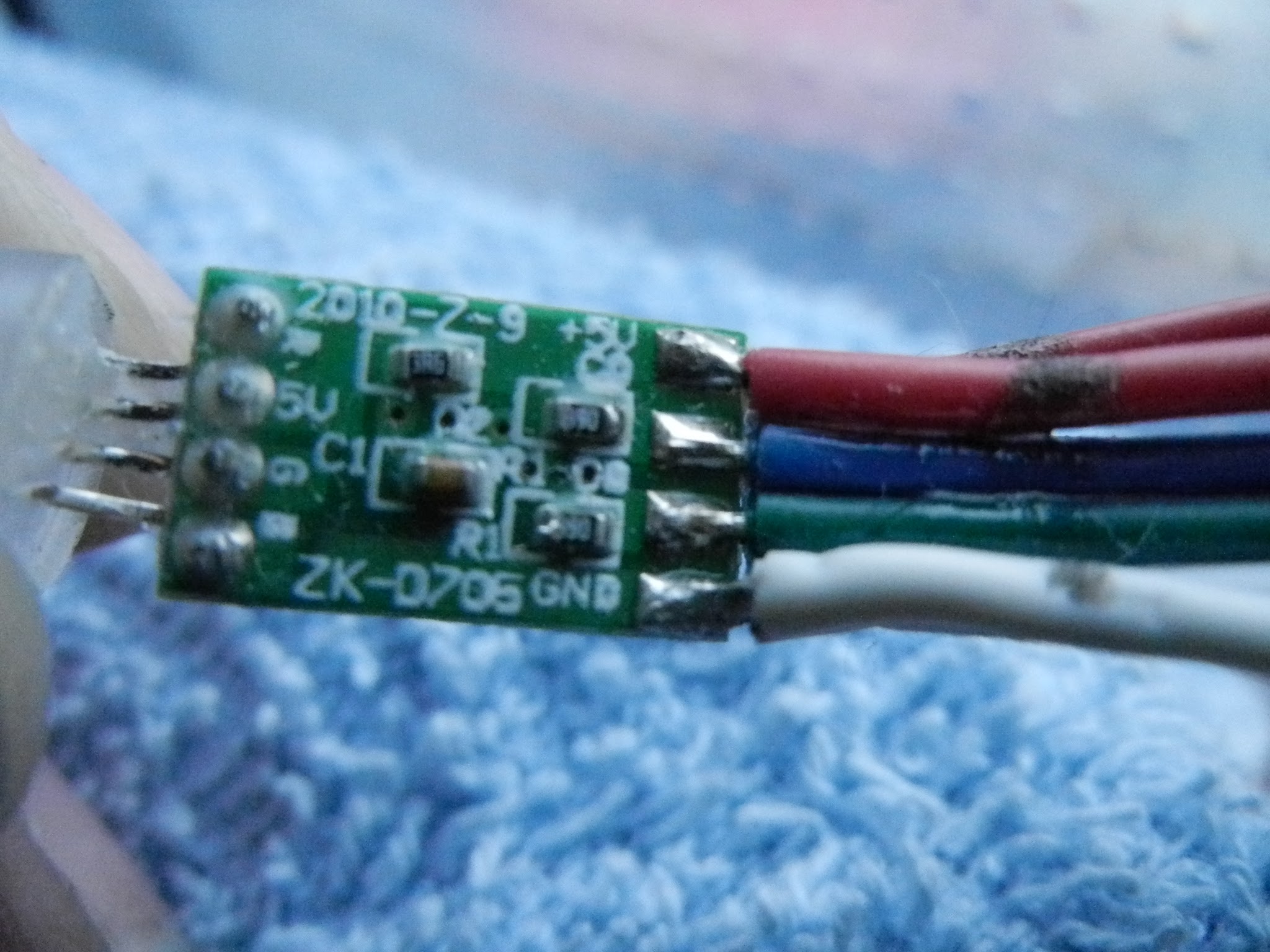

I´m having not the knowledge to operate these Pixels. I tried it with the lpd6803 strand test. But it doesn´t work.
They are sealed in silicon. I extracted the one on the foto on the left. 5V red wire-gnd white wire-clock blue and data green wire. I knew that they need seperate 5 Volt and gnd to the pixel and the arduino. But it seems that I do something wrong or don´t know about the Pixel o the code to run them.
It would be very nice if someone can help me.
p.s. I cut off the first pixel because the first time I run them with 12 volt. ;-( But now I´m a little bit cleverer. :wink: The led´s are still working. But what is with the IC´s?
Thanks
Jörg

I installed the lpd6803 rgb master von adafruit and have all in the tutorial doen(inclusiv the TimerOne). But no reaction. So what can I do???
Are you sure you’ve wired on the input of an led and that you didn’t have clock and data backwards?
Also, if you applied 12v to the line there is a chance you fried more than just the first led.

Because I worked the ada fruit tutorial very accurate through. And I tried if the manufacturer does a mistake with the wirering(what is very probably).
I think that I fried the IC´s with 12 Volt. But good to know that maybe some survive.
