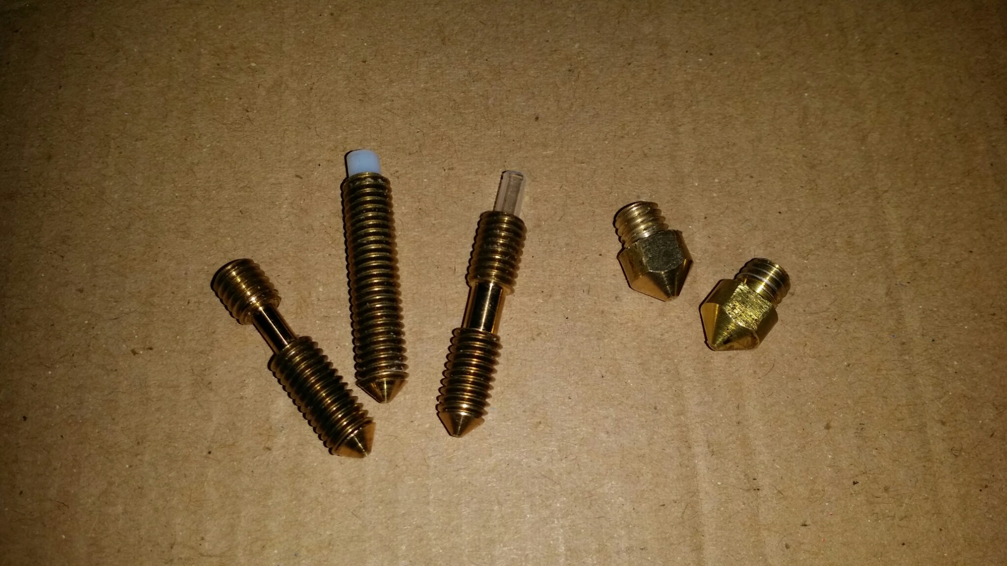

And because I’ve spend some time on the lathe anyways I made some nozzle variants for my new self-made hotend benchmark.
And some new nozzles for the rep2x in 0.3 and 0.5. Not because it’s a good idea or to save money. Only because I need them and my supplier haven’t send them yet. I should definitely have some on stock.

Hi, Sven! I would like to take in PTFE protection. The material is up to 260 ° C temperature resistant, and more does not need the filament. It is, unfortunately, common practice, at higher speed to increase the temperature. This is, in my opinion, the wrong way. Rather than raising the temperature you just have to build a longer heating block. Thus, the plastic will melt easily and quickly even at NORMAL temperature. I have already built and tested 3 long hot-ends, it works very well (I have pictures and videos uploaded).

This is more or less the plan for my complete new hotend. But on the rep2x I’m actually limited in space.
And it’s way easier to change the Temps than changing the hotend actually. And you will have probably more leakage/drops even with retraction with a bigger melting zone on lower speeds. That’s also the reason why I started with my own hotend design for the new printer.
