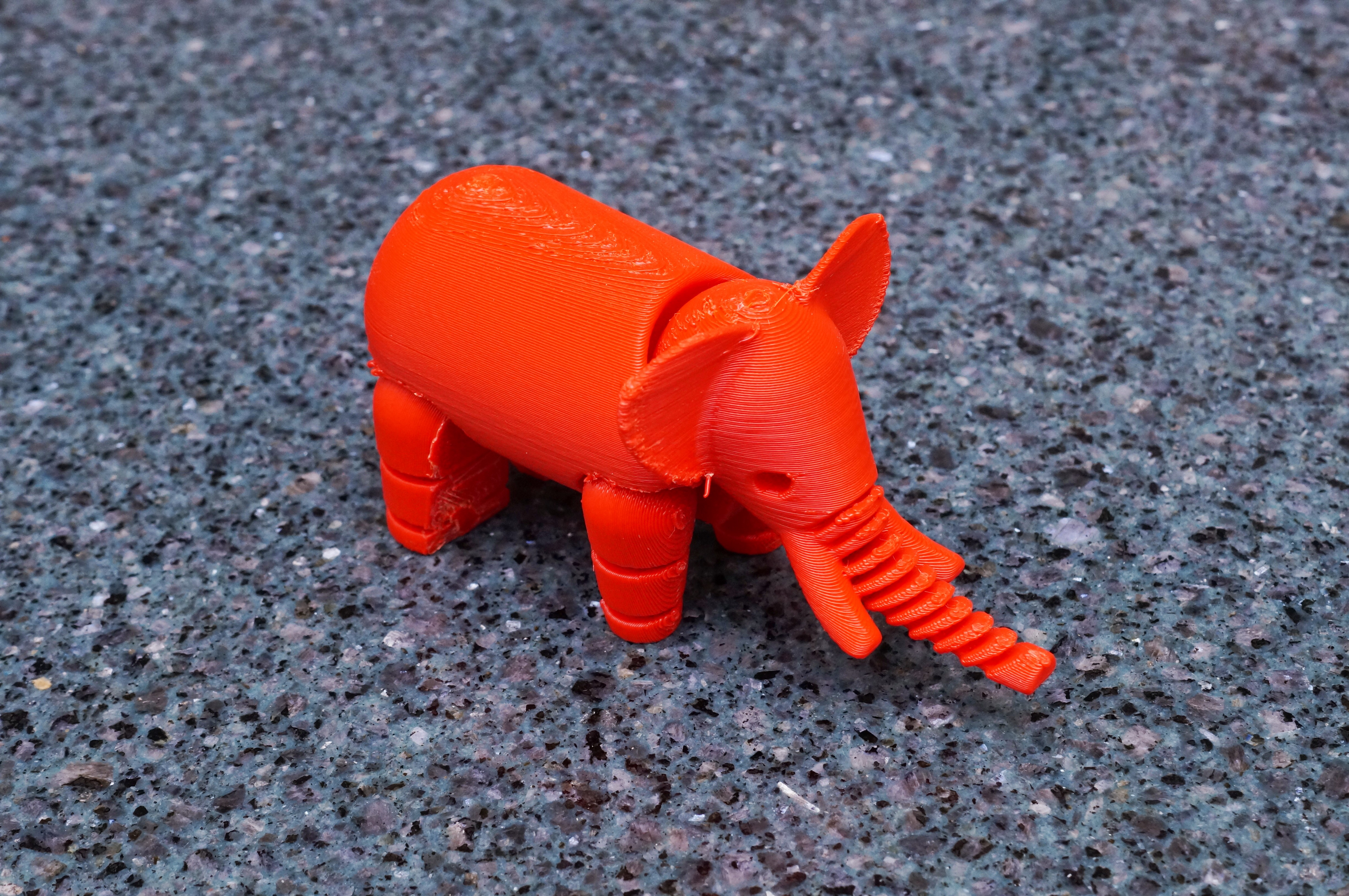

Still waiting for the heater bed parts to arrive but wanted to test Kisslicer
Still waiting for the heater bed parts to arrive but wanted to test Kisslicer and a bit of speed and the LFS elephant seemed perfect. The material is ABS at a temp of 235ºc and layer height of 0.3mm to save time. Speed wise it was set at 55mm/s loops, 60mm/s solid and 75mm/s sparse, with 1500mm/s^2 aceleration. Bit of sagged filament around the legs but otherwise worked ok. There is a split in the back also but no heated bed and a cold room doesn’t help a model with only 10% infill. Video of the print http://youtu.be/MLT7o9k2VZ4
Quesion is though I am amazed how well the model stuck to the masking tape even with a cold bed. So amazed in fact that it was near impossible to remove. The UP printers always print a raft so easy to get off just using a scarp scraper. What is the trick in removing your models unscathed when printing directly to the bed?
Thanks for any tips

I been using painters tape and wiping it with acetone. Parts stick way good but sometimes the tape lifts. So then it’s off to retape the bed. I been playing with low infill (20%). It increased my time a tad bit.

I was gifted this elephant! Maybe not in that colour. It rocks. I believe the trick was to lay down some throw-away plastic using a spatula/paper towel that can be rubbed off once the plastic dried. Else, maybe grease?
I have a glass bed heated to 90 Celsius, I’m having luck printing directly on the bed - no tape, no glue. I have to let it cool to near room temperature and just pick the object off the glass. For the rare case where it stuck I use a paint scraper carefully around the edges, working towards the centre.

Is it scuffed a tad? I have an aluminum bed.
Thanks for all the great advice guys. I have a piece of glass to go on the heated bed so sounds like this wil help alot. . Also seems I need to get the get the enclosure built as a matter or urgency. It will be a combination of thin sheet metal (painted) and perspex I think.
I print it fine without raft.
@Zane_Mitchell There is a small deformation right in the centre, but the rest is perfectly smooth. I wipe it with a wet cloth, then dry off before printing. I also clean the extruder nozzle with a small wire brush before every print. If I am printing something tall and thin, I print two of them so the extruder is forced to leave one to dry while it prints the other. Otherwise it tends to fall apart as it nears the top.
