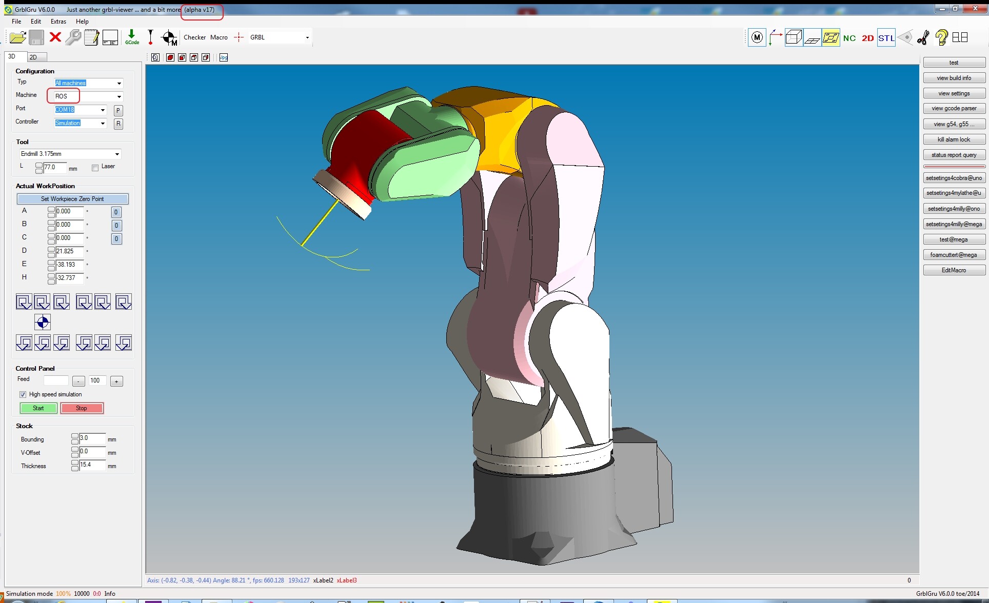

This is a very nice model. ![]()
I have only corrected some small things like axis names and entered the rotation points of the rotation axes in the MachineManager. The loading time of the model is a bit long because there are very many small surfaces. Especially surfaces in the interior, which can not be seen, could be deleted to make the model a bit more performant.
I have included the model with the name “ROS” in my current alpha version V17. You can download it from my website. https://www.grblgru.com/Alpha
Have fun with it

In the attachment you can find the STL files I used for the model. Please rename .step to .zip and unzip to get the STLs.
Wish you much success ![]()
