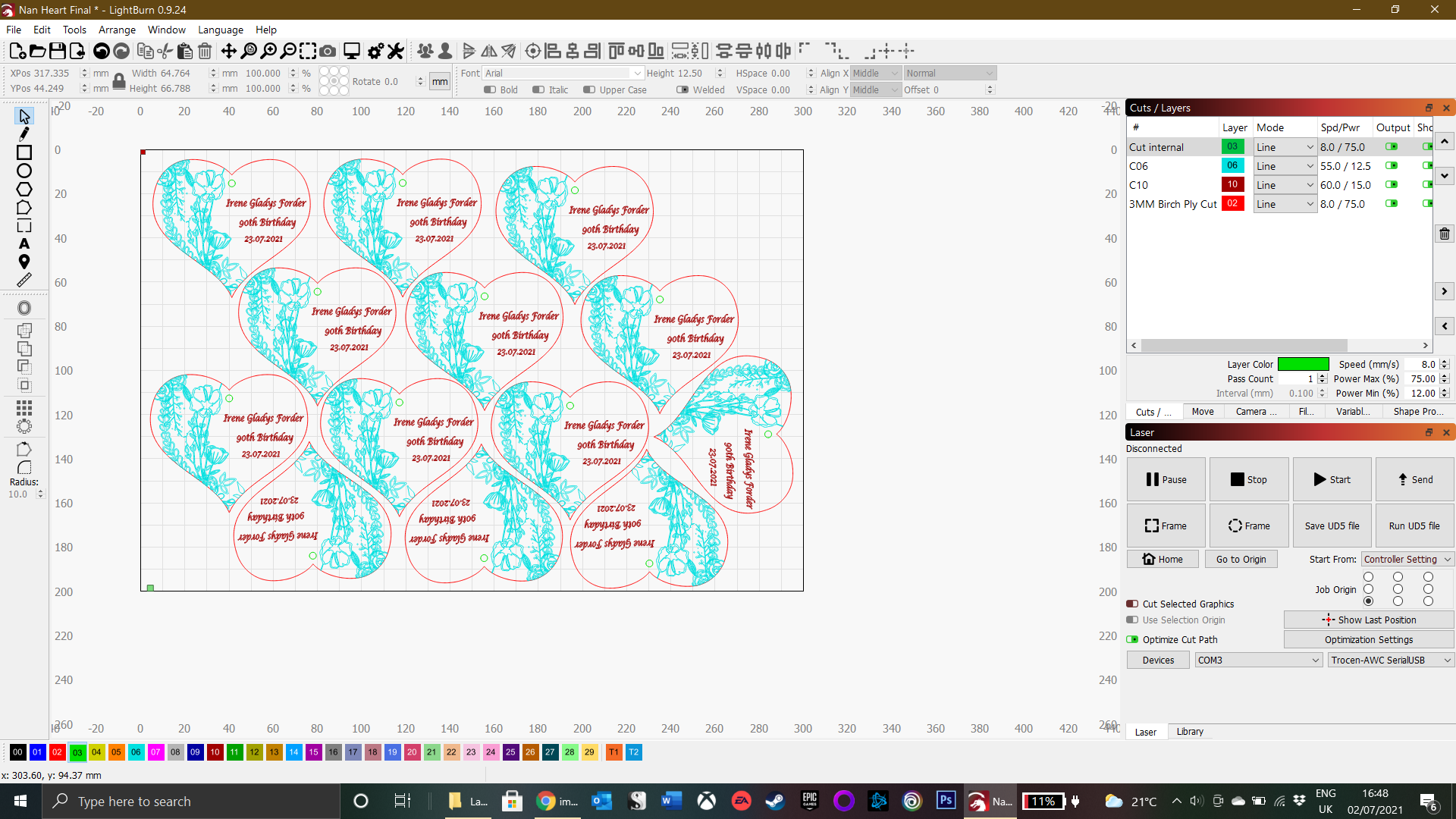

I have attached a picture of the file in light burn and a picture of the result in the laser, can anyone explain what has happened to the alignments and more importantly, where I start when it comes to sorting it out?
The weird thing is, the last heart that was cut, the sideways one on the right-hand side of the image, was the only one that was aligned as it should.

The sideways one is also off but because you lost some steps along the X axis the hanging hole and the points are still lined up.
Most likely the belt is either too tight and causing added friction in the motor or the motor bearings are worn and have more friction when moving fast and the tighter belt exacerbated that.
