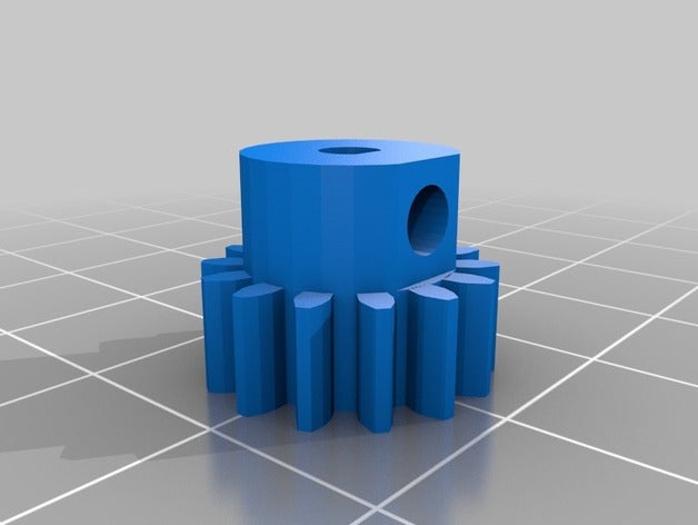

Slight mod to F1 pinion gear. It was spinning off the motor on my model. Use a 4mmx4mm set screw and a 4mm tap. Find it at Thingiverse:
(repost for better photo)
