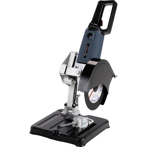

Seriously, don’t waste your time with other toys. Just use this :
@Sven_Eric_Nielsen Brand, type ?
In my case it’s Einhell. But it doesn’t matter. I think even the cheapest thing you can get will do this simple job.
