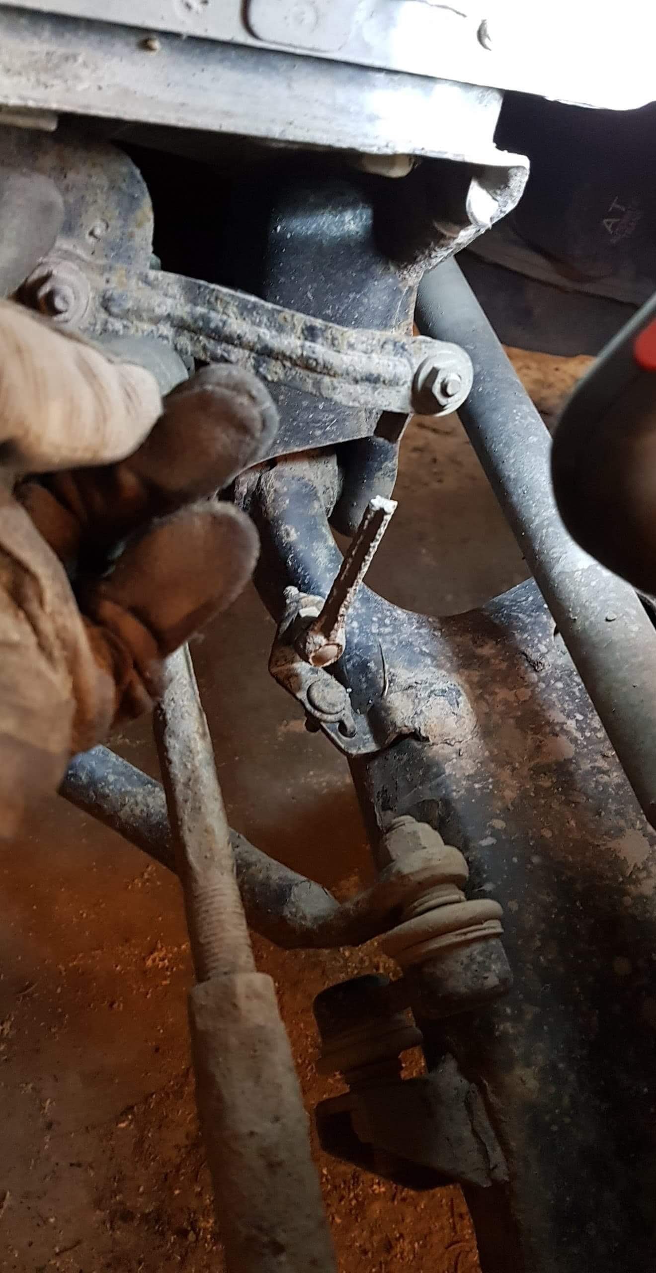

Subaru hid level sensor arm broke on my Subaru, kept the ball ends and printed a new arm. 350$ saved! Love my printer…

That’s a good part for 3d printing, doesn’t ever receive high stress and the car actually works without them. Im curious to see the wear on them over time tho, keep us posted
It’s printed in abs. If it wears out I will try to reprint it in nylon. But I did grease it with silicone grease

good for temporary fix, but not forever, you used two different metals next to each other so they will corrode possibly, also there is no rubber sleeve on this so the lubricant you applied will attract dirt etc, and then it will wear off plastic bearing, It would be better if you designed part to put broken part together tightly and reinforce it with fiberglass and epoxy maybe if you do not have possibility to simply weld broken part together, I would also If I were you, take other part off and apply coating to protect them from further corrosion becae if left one broke right one will brake one day too. Lucky you still have both parts. Nice good luck.

there is nothing wrong with using plastic parts on a car by defenition open your hood and you will find massive amounts of plastic parts, its purley a case of dimmensioning correctly and use case. The reason the original part failed is becuse the ball joint seized (rusted shut) witch created a moment on the arm (breaking it). The plastic arm wont rust and therby not seize.

@Piotr_Sitko I cant say that i agree with you here… there is not two different metals in contact to start a sacrificial anode situation, are you possibly thinking of the locking pin? the contact of this pin is minimal. You are right about the lack of rubber sleeve however the amount of lube is minimal and if it is a problem i will reprint in nylon and not use any lube (i do have dry lube but nylon does not need it in this application).
As i have explained the reason the original part broke was do to the ball ends seizing so only repairing the arm would not work (it would break again really fast do to the moment created).
There is only one sensor on the car so no need to protect anything with a coating on the other side.
@Greg_Dimas You are correct if this was a high stress application but remember this is only for a level sensor, I can easily move the arm with my finger. This is more of a abrasive wear application where self lubing, wear resistans and environmental properties is key before strength. However PC is not a terrible choice ether.
