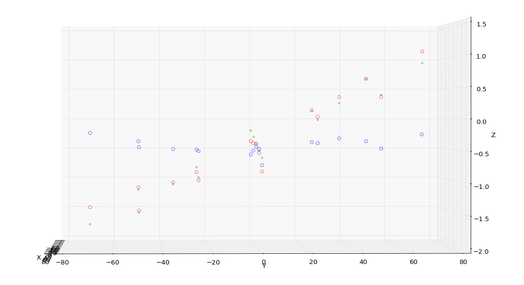

Success! The Probe routine (G29) now seems to be working great! I think my
Success! The Probe routine (G29) now seems to be working great! I think my WIP DIY probing effector might have some pretty bad accuracy across the bed, but OK precision. I’ve committed my changes and so I think it’s time for a minor bump due to this. Perhaps let it simmer for a bit and get some feedback : )
You can generate a new G29 macro by running G29C. Right now it makes a polar style probe pattern around 0, but it might serve as a starting point.
