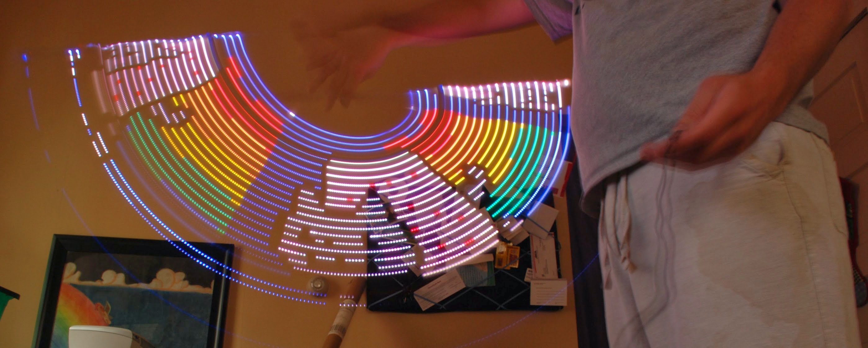

Successful POV test of self-contained system. Image from SD Card, lipo battery powered, mini OLED screen working, now for the bluetooth interface… Thanks for all the hard work on RC1/RC2, I’m able to fit WAY more stuff in 32K.

How many colors are you using?
@Ashley_M_Kirchner_No 24 bit color in the source .BMP file, 8 bits per color.
The nyan 8bit graphic doesn’t have that many in it, obviously.
