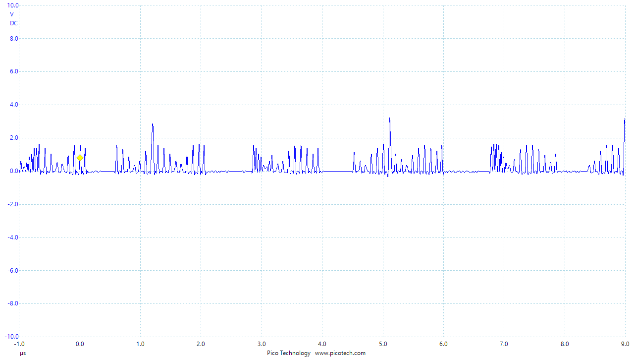

I’d expect something like that to be a hardware problem, so poked around looking for issues. Power is all good. Grounds all seem connected. Scoping the DATA line shows nice square pulses; scoping CLOCK shows nasty spikes, as per pic. Looks like the Teensy is attempting to produce pulses, coz the timing and pattern looks reasonable, but these are the least square pulses I’ve ever seen. I am amazed the strips can pick up any information out of that. But I can’t find a hardware issue - this is unchanged hardware that was working previously.

Also what rate is your scope collecting at? I wonder how well it would handle a 24mhz clock (which is what fastled defaults to for apa102)
