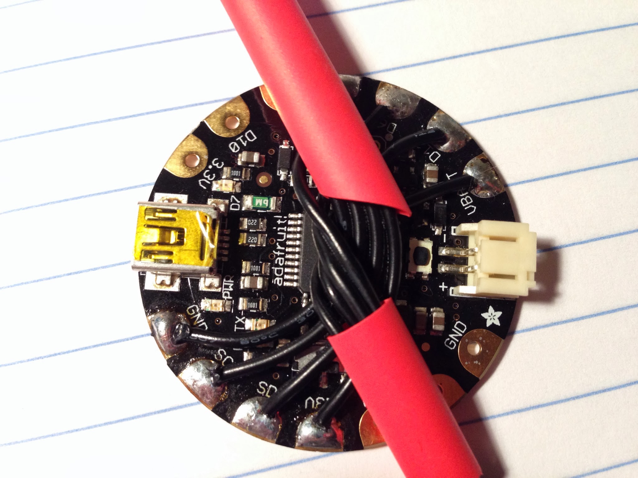

Suppose that you wanted to Playa-proof an Arduino and some LEDs…
Originally shared by Reed Morse
Photos and tips for making rugged electronics.

My favourite resource for this, “What Your Shipment of Fail May Arrive In”: http://wiki.orbswarm.com/index.php?title=Building_Electronics_and_Robots_for_the_Desert
Wow, that’s a great page right there. Thanks!
It’s pretty brilliant. I’m a convert to the church of E6000, it’s great stuff. “Hot melt glue does exactly that.”
