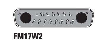

Sure wish connectors didn’t confuse me so much. Finding an ideal, power rated, elegant, cheap solution isn’t easy…Check out this Molex part…looks like it’d handle a dual extruder easily. Now, price all the pins, coax connectors, figure out the cable side with stress relief…oh, and they STRONGLY suggest crimp connectors…drop some coin on a good crimper.
Well have never seen this connector before but this looks definitely not as a crimp connector! Where did you find this connector?
It’s a molex part, http://digikey.com sells them, but they’re not cheap. The larger holes are for coax.
Can those coax connectors really take the current? That, and I wouldn’t enjoy crimping those coax pins.
I suspect so, on further reflection, I’d be more worried about fatigue due to movement…
