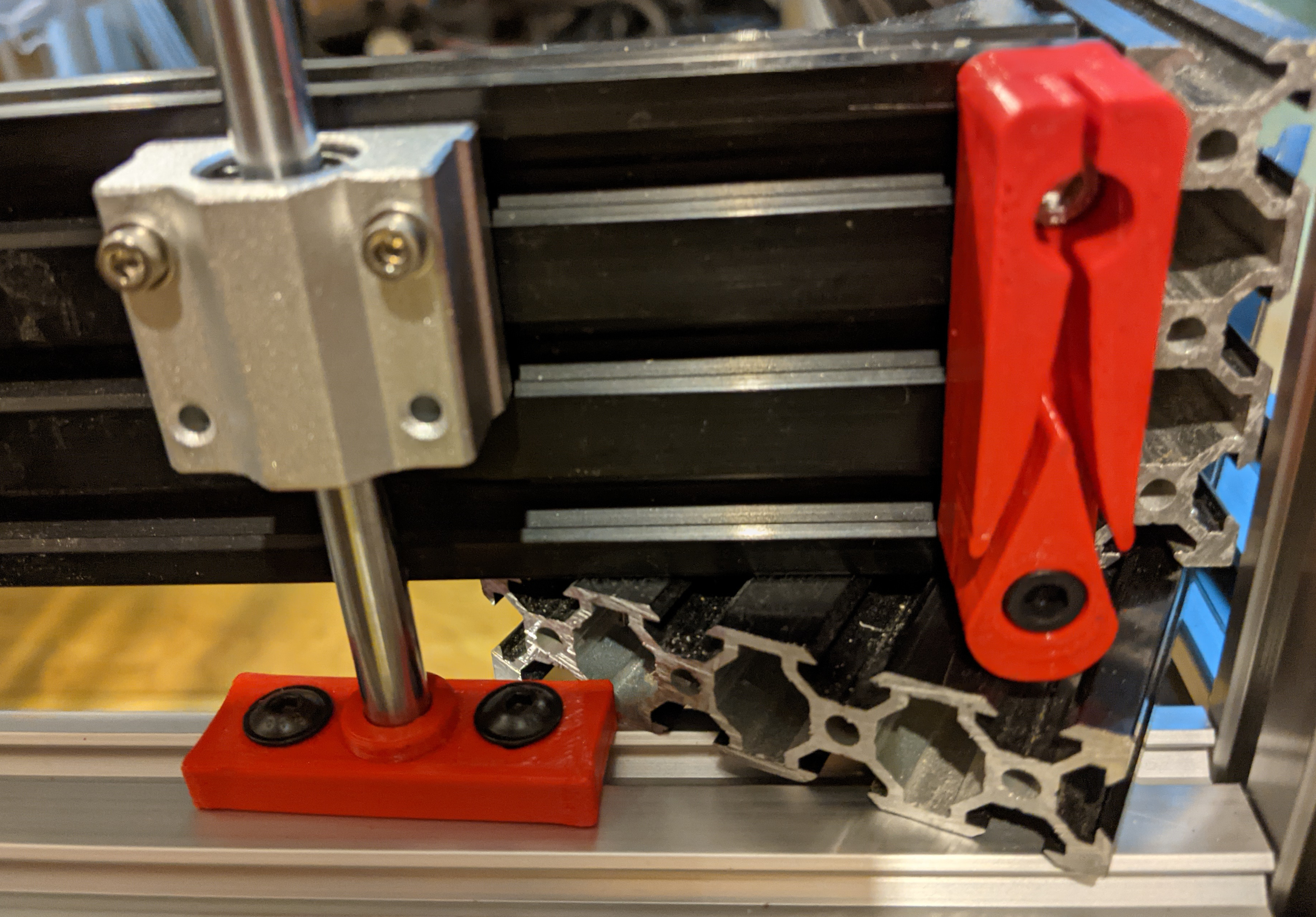

Here’s a sadly blurry picture showing the SC8UU blocks, printed end fix blocks, and suspension blocks as attached.
Note that the holes in the SC8UU blocks aren’t on a 20mm pitch so I can only use two of the holes to attach it to the bed frame. That’s OK.
Installing those rods which I had ground to length within 0.5mm (and probably better) made it clear that one of the corners had slipped down about 4mm in all the disassembly and reassembly I had to do, so I fixed that too.

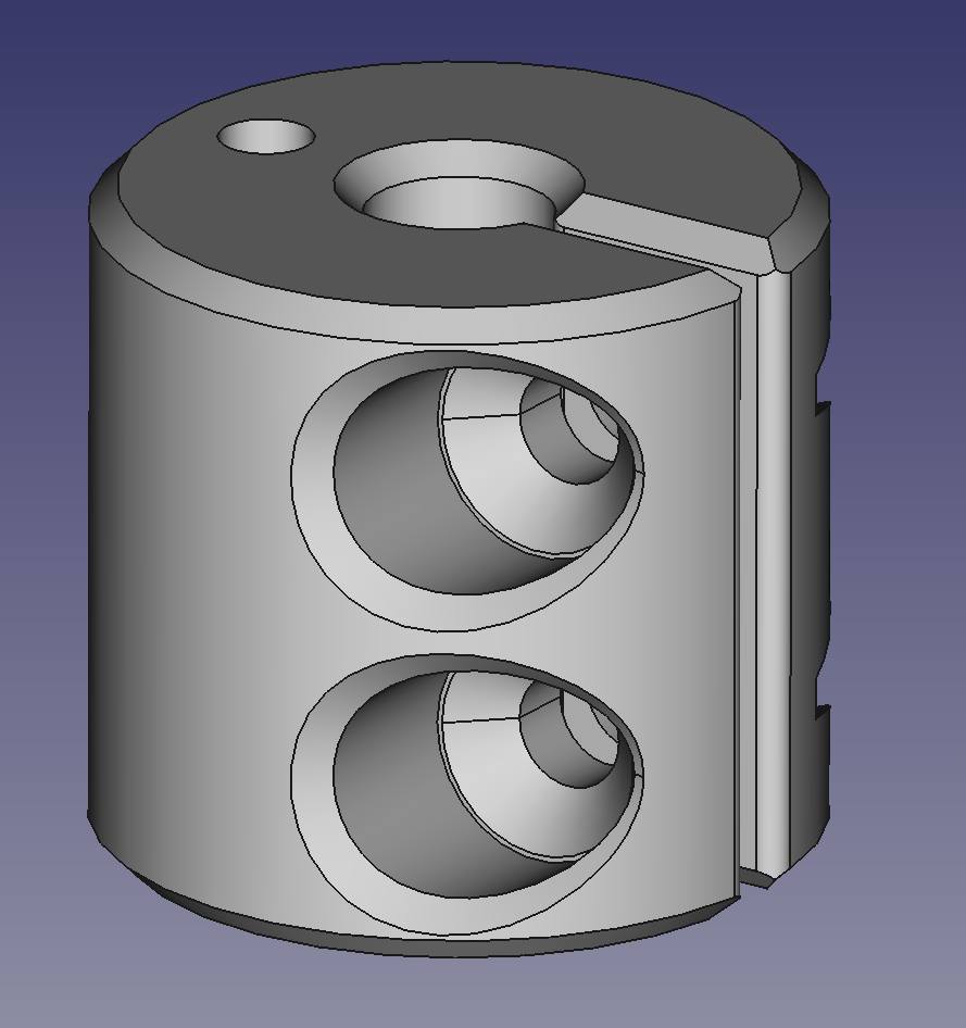

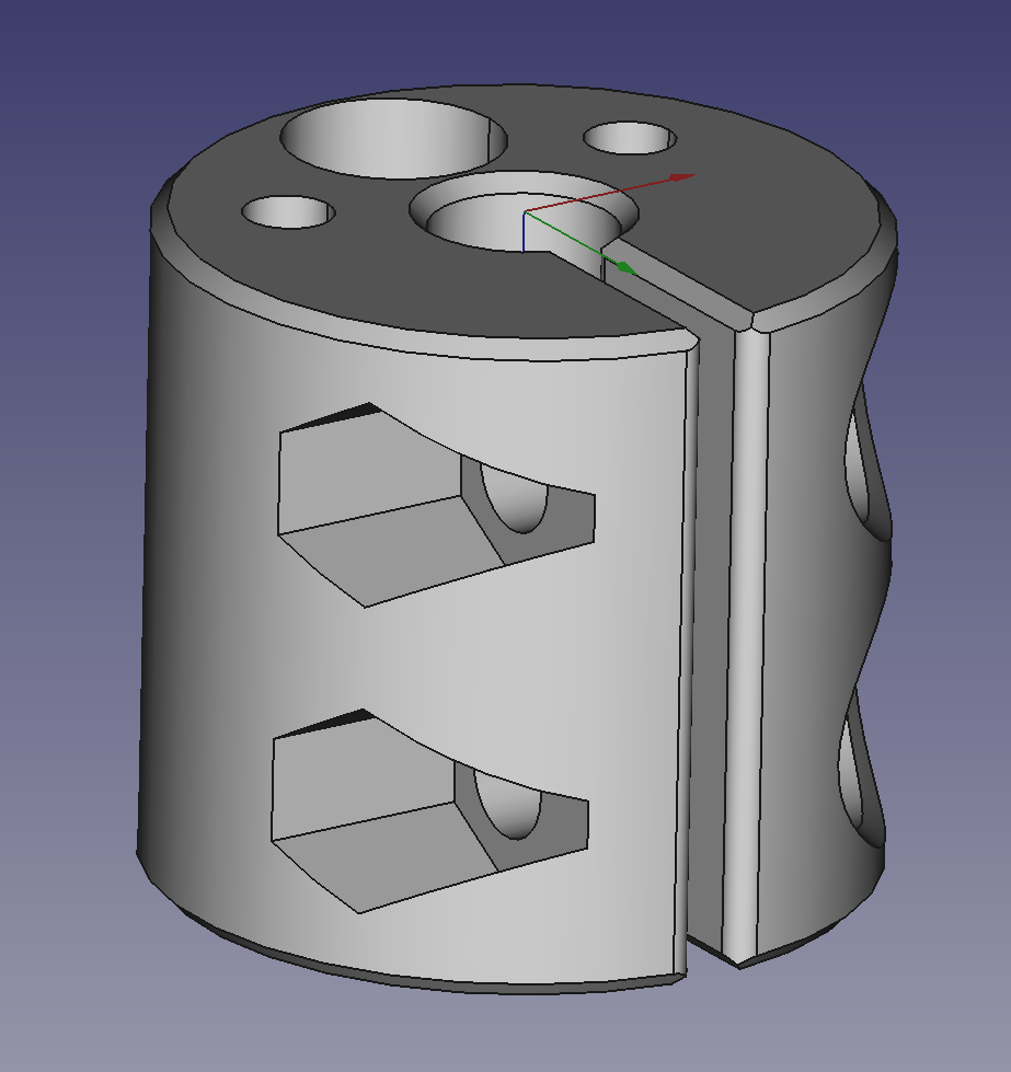

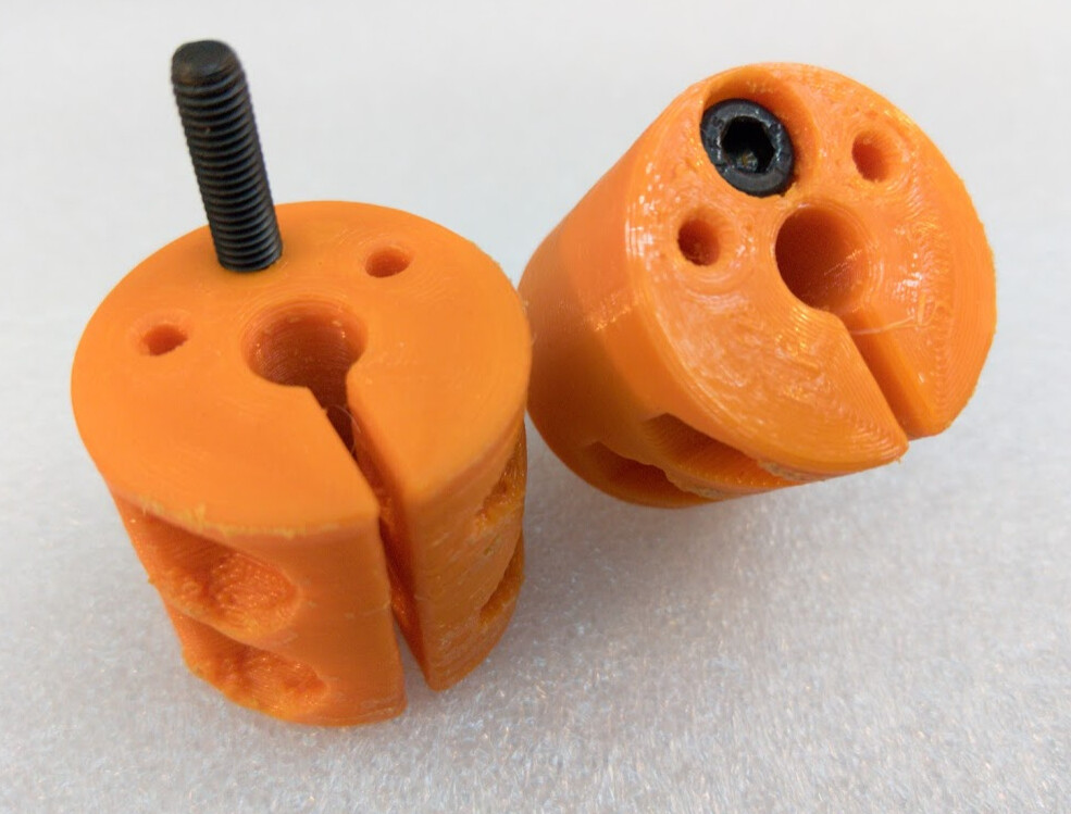

I’ve switched from M3 to M5 hardware, and I added a hole for an M5 bolt through the body to act kind of like a “dog” — I plan to run the cords through the split and then lock two nuts together around the cords on the far side of the split, and use that to fix the cords to the shaft so that as it turns it lifts the whole bed level.
Imagine two M5 flat-head screws in these two holes in the side:
…screwed into M5 nylock nuts on the other side, with printed hex sides that act as a wrench:
(Yes, the outside is really narrower; that’s to aid in disassembly if necessary.)
The hole in the top is tapped M5 and a 40mm M5 socket-head screw goes through it. Two washers (including a lock washer on the outside, I think) lock around the UHMWPE cord:
Anyway, that’s printing now; hopefully I find this evening that it works. :crossed_fingers:
The first one took 1.5 hours to print. The move from M3 to M5 hardware created larger unsupported overhangs that printed worse, but sere still good enough to use.
The main difficulty I had was that the hole down the side is 30mm tall, and I don’t have an M5 tap with quite 30mm of cutting area. I ended up just pushing a few threads out of the way at one end to have threads all the way through, and it worked fine. PETG is a bit of a pain to tap. It really gums up in the flutes, and even with spiral flute taps I can only tap about 5–10mm at a time without clogging the flutes and having to back out and re-cut.
I haven’t tried a strength test. It looks good enough to print a second. At this point I plan to just install them both and test them.

I printed the second and tried an installation. I was able to lift the bed by turning the torsion rod, but it wasn’t perfectly level, and adjustment was extremely difficult. Part of this was because I had expected to be able to adjust it with the cord pulled through the slot underneath the clamp-closing screws, but the cords got a bit pinched between the clamp and the rod and hung up subtly, so one side was under slightly less tension than the other.
The side hex recesses turned out not to be tight enough to hold nylock nuts solidly, so I had to test with regular nuts.
I used an ULP screw head for the dog screw that holds the thread, but it still seemed likely to tangle the cord around the head as it turns.
The next design iteration buries the head of a standard M5 socket head screw to avoid tangling, which also solves my problem with short M5 taps by reducing the length of the tapped segment. I have added a hole for the cords to go through from the head side to the far side, and because I don’t know which side will work better, I added a hole on each side. I left enough plastic to be strong enough not to break. I reduced the nut clearance, hoping that might make it possible to use nylock nuts, but I don’t think it will matter in the end.

Here it is, printed, with just the dog screw installed:
Now with the fixing screws installed:
Installed on the Z torsion rod:
My son helped me tighten it as evenly as possible, line everything up, and then crank the bed up and down.
  • The bed moves smoothly up and down, even if the corners are out of tram by over a centimeter.
  • Trammed as well as we could, the corners were out of tram by over a centimeter. This means that getting the tension even on all four ends in each bundle wasn’t feasible with this design, and I don’t have ideas for how to make it secure and adjustable that make sense to me.
  • The cord wrapped around the tension rod nicely and tracked along the rod in a spiral without wrapping over itself. So if we had been able to do fine adjustments, it would have worked nicely.
  • The suspension blocks were great. The line stayed put. They are clearly very strong, but also very easy to put the cord onto and the cord stays put. I really like this design.
  • This last version of the tension rod cord fixture didn’t slip on the rod. Might finally have that solved, just in time to abandon the project.

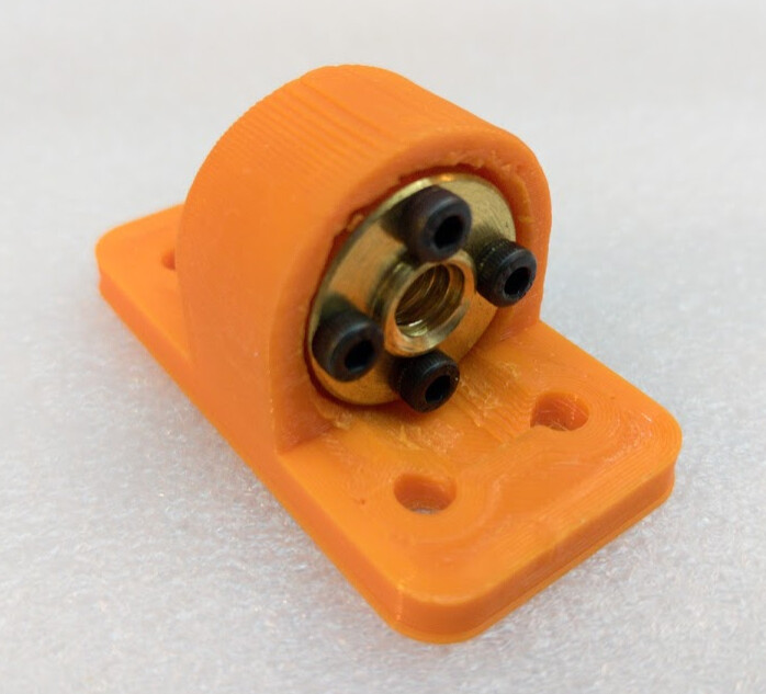

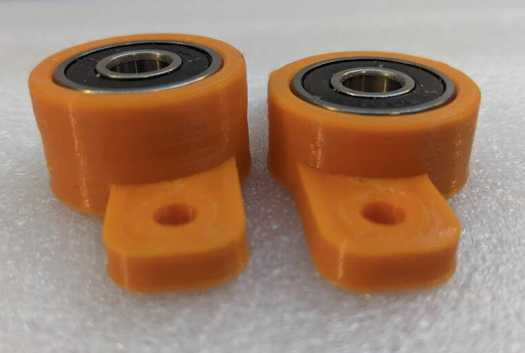

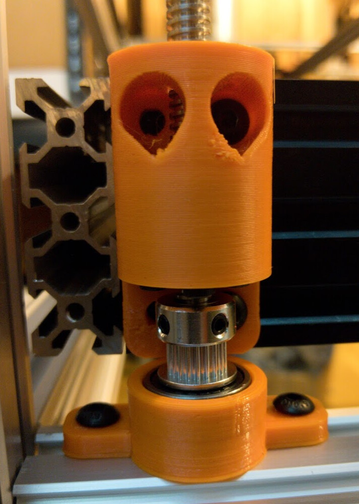

I bought some tiny thrust bearings for the bottoms of the lead screws, and will use the same trick of 3D-printed bearing blocks, but these will have pockets for the thrust bearings as well.

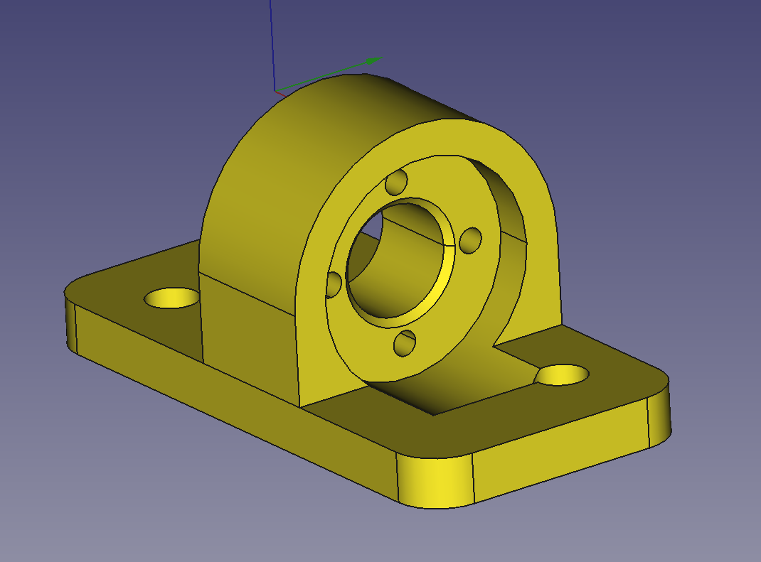

I augmented my design for the pillow blocks to add these offset bearing blocks. They are asymmetric so that the edge of the bearing block section is lined up with the edge of the 2040 v-slot on which it is mounted, and the mounting holes in the flanges line up with the slot below them (centered 10mm in from the edge).
Here’s a bottom/top pair; the bottom one is thicker because it includes the thrust bearing.
Looking from the top, you can see the cute little 8mm thrust bearing at the bottom. There is nothing but grease holding it all together! The 608 bearings are held in firmly with crush ribs, but the 8mm top race easily sticks to the rod riding on it and can come out through the hole in the 608 bearing, so being careful not to lose the loose bearing race is important. The fact that they can come out should make it easier to re-grease them if there is ever evidence that they need more grease…

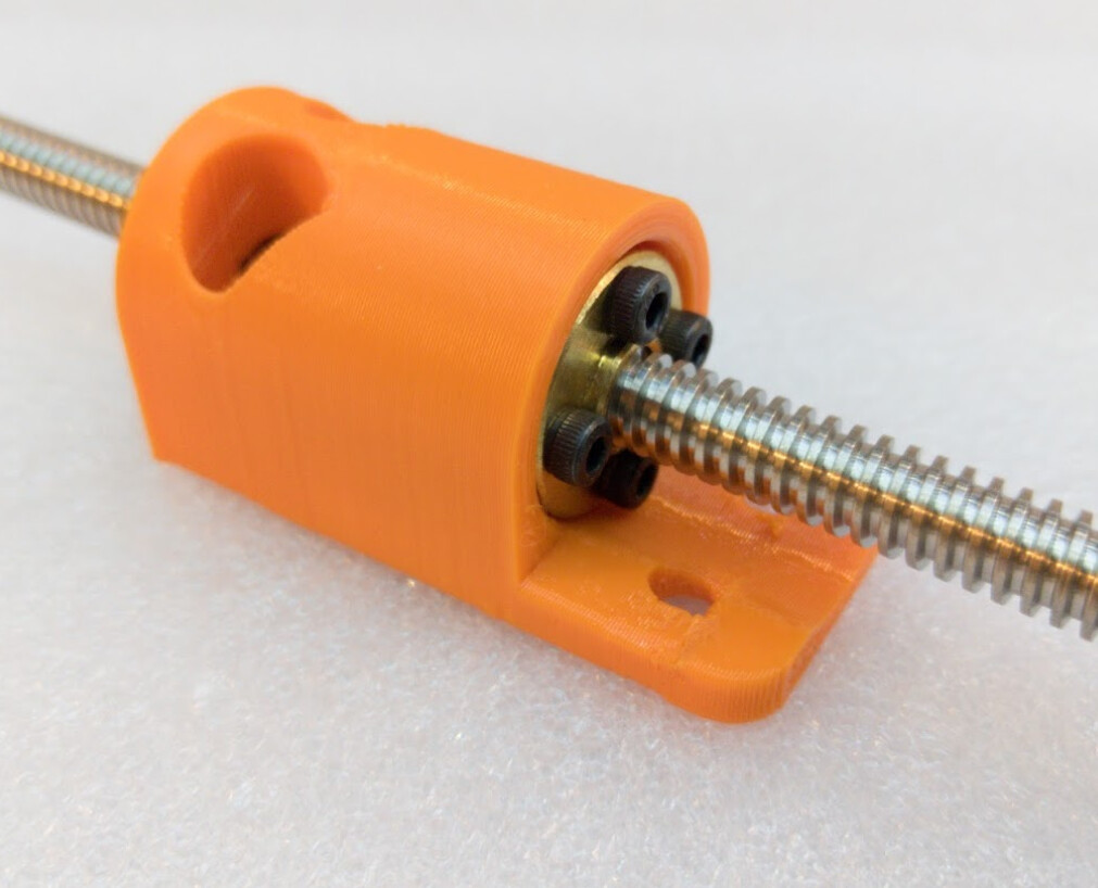

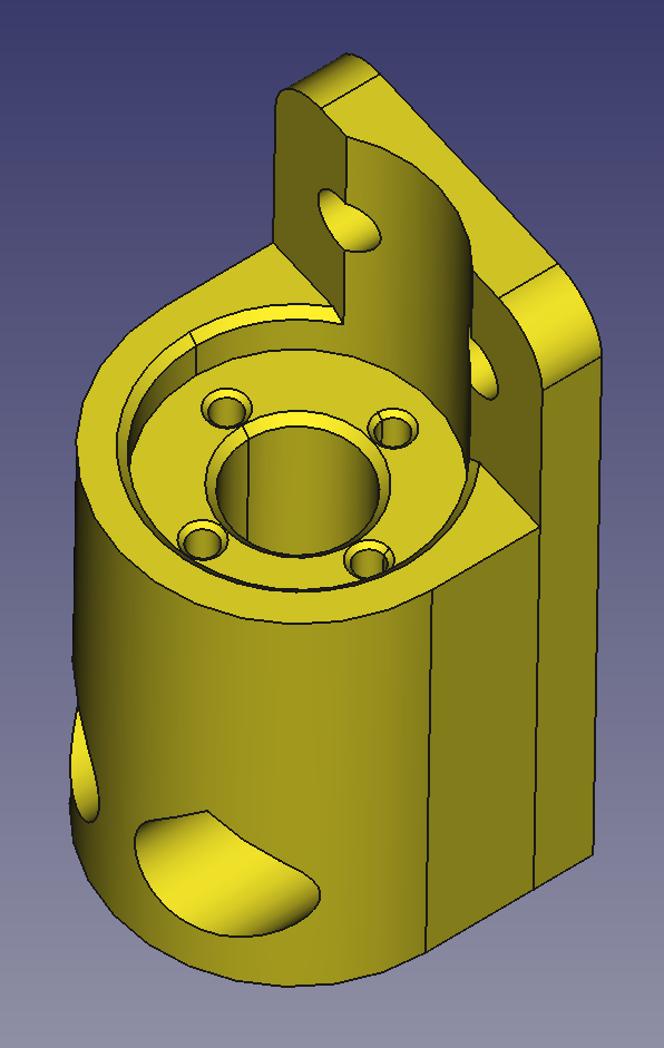

I next need to model parts into which to install the trapezoidal lead screw nuts, that hold up the bed.
The offset holes in the base are offset to make assembly possible. A lead screw runs through the middle of that hole, and if the mounting screws were aligned with the axis of the lead screw I wouldn’t be able to attach the assembly to the bed frame because the screw would be in the way — but I can’t attach the assembly to the bed frame first because then there would be no way to insert the screw.
I will assemble the nut in this block, then the lead screw through the nut, a timing pully on the bottom of the screw, and then put the top and bottom bearing blocks, and then slide the whole asesmbly into the side of the main frame and attach this new block to the bed frame.

I printed the remaining four and put them together this morning, and I am not satisfied with this design.
I redesigned it to align critical holes and faces with print direction, and made teardrop-shaped large holes for mounting screw heads to print without supports in this orientation:
This is upside down relative to how it will be installed. The flange of the nut bears against the inset face, and that carries the entire load of the bed (across four screws) down to the thrust washers. This will not only print without supports, but also has the layers aligned to carry the load in the strongest orientation, and is simply more plastic and will be stronger.
(I know, four lead screws isn’t exact constraint design, but then a 2060 1.5 meters across and 850mm deep isn’t exactly perfectly stiff either.)
The teardrop counter-“bores” work well enough. It’s a bit ugly inside but it doesn’t impede function. The M5x8 mounting screws inside those counterbores are captured by the lead screw but only barely, and can still be turned with a driver with the lead screw in place. This is pretty much exactly what I wanted. The mounting holes aren’t perfectly shaped but there is no reason they need to be. I didn’t use heat-set inserts for the M3 screws holding the flange; there is no tension on them; they just need to keep the flange from rotating, so I just tapped the plastic directly. It’s not a strong fit but it’s plenty good enough. I’m printing the last of the set of four now.

Tonight I mounted all four lead screws. It turns out I could have used all four screw holes in each of the bed stage nut holders:
The M5x8 pan-head screws I used just barely fit behind the pulley, and everything fits together snug. Obviously, once there is a belt around the pully the bed frame will not go this far down and the screw head won’t matter anyway. I’ll have to have a stop of some sort then.
