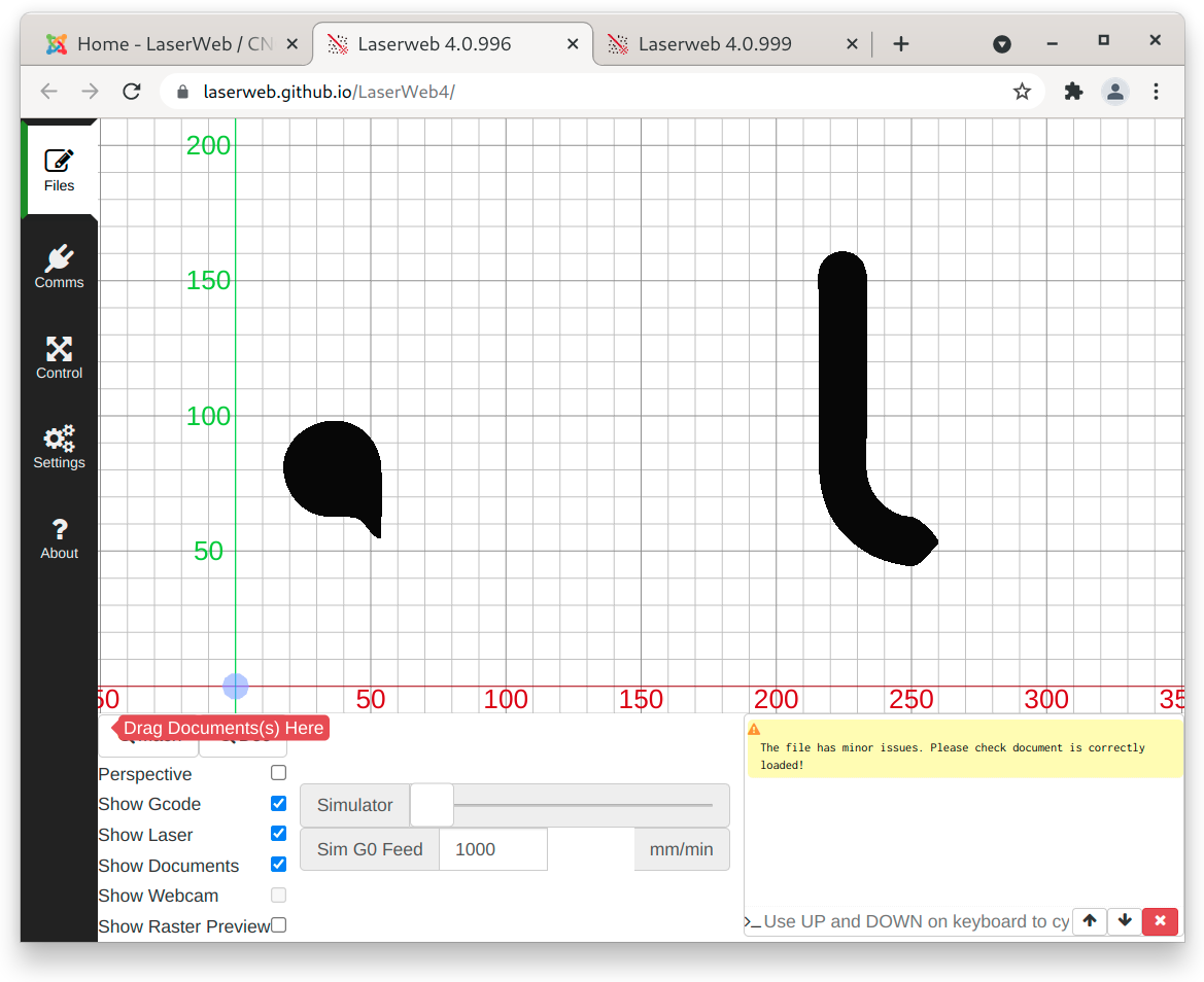

Ok, so I have a small .svg file that I’ve had the goal of getting to import nicely into LW. Currently it fails like this:
The actual SVG is:

When you load an image into LW it is initially parsed to a tree of individual svg tags, but after this the data is split. One for the image to be used in the display, and separately to obtain all the cutting paths within the image.
The tag processing was failing for the displayed image, while the path extractor would normally work even if the image looked like gash in the display.
  • I would often load SVG’s that looked terrible while laying them out, but still worked if you generated cutting operations from them.
Earlier today I finally worked it out, Floating point precision is really messing things up, tiny errors were accumulating in the maths, the end result being that paths were not being ‘closed’ since the end point might be different by 0.00000001 units from the start point, etc. This made the ‘is this path starting/ending at the same point?’ tests fail to mark the path closed.
  • This badly affects the display tag processor
  • The cutting path generator has more tolerance built in against this
The ‘Success’ image above is the result of me doing some simple rounding on the paths before they are stored, eg x=number(x.toFixed(4)); and similar as the values are added to paths.
