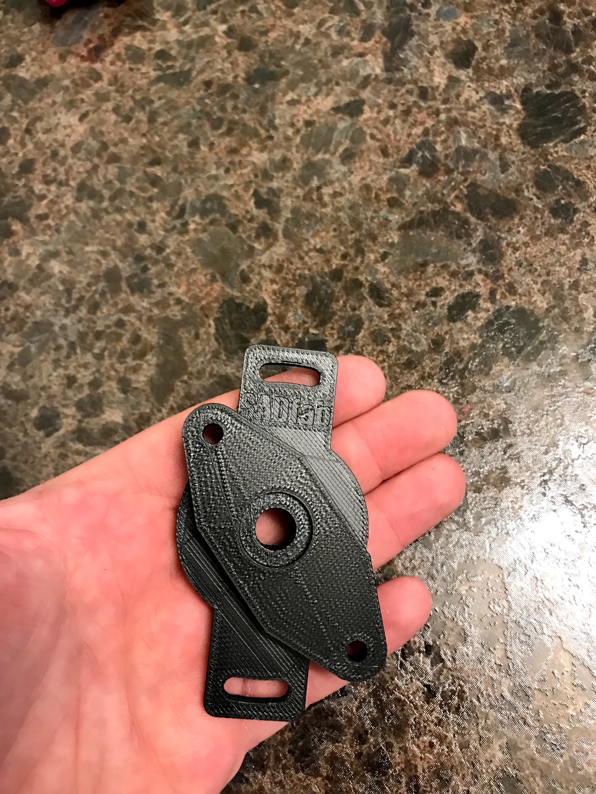

Switched from PLA to ABS and came out with this! 3rd print I’ve ever made in ABS (and the first two were calibration prints). This is a TPS bracket for a Mazda 1.6 L Miata to use a Kia TPS. Turned out really nice! Maybe it’s my RB2 printer, but printing in ABS doesn’t seem to be as intimidating as I thought it would be. I didn’t have to do any tricks with bed adhesion. Just a good brim.
My ABS prints would always start nicely but they’d peel themselves off my printer bed before finishing with curled corners. This looks great!

@Fen11 yeah! My first calibration print curled a lot, but it didn’t have a brim. When I put the brim on, and smashed it into the bed pretty well, it worked great!

Really nice job here! Was the printer enclosed or did you leave it open air?
@Jeff_Parish I enclosed it with cardboard. Not the best enclosure, but it seemed to do the trick.
It gets harder as the prints get taller. Printing a tall-walled box of significant size will curl off the bed unless you have an enclosure for example. A simple enclosure helps a lot. I have a simple box made out of fake garden-centre bamboo, 3d-printed corner pieces, bubble wrap and duck tape – works well.
