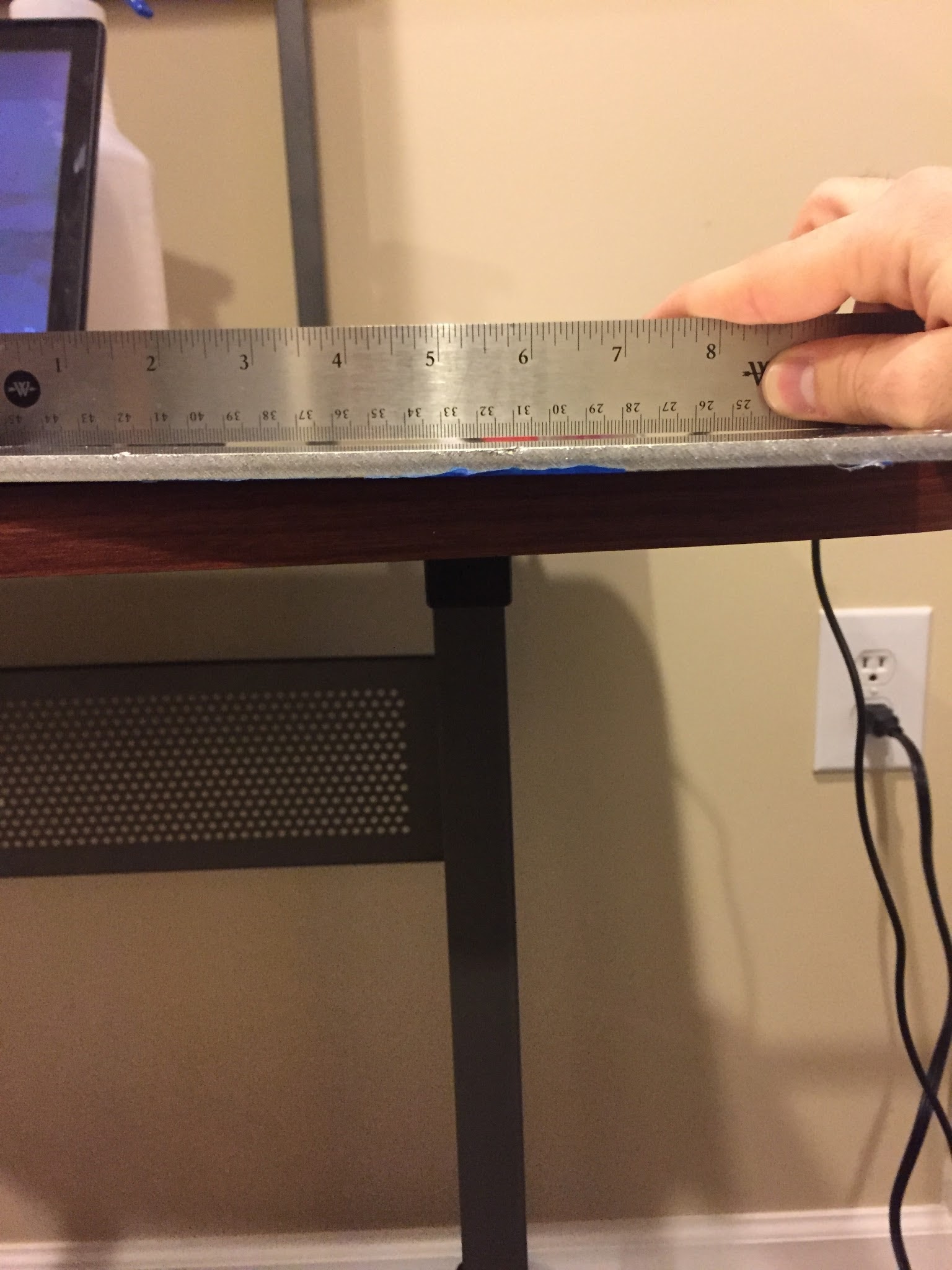

Switching all my printers to Mic6 whenever I find a deal on a sheet
Switching all my printers to Mic6 whenever I find a deal on a sheet that’s useable. Last week I found a 250x310mm sheet of 1/4in. for 2 for $28 shipped. I haven’t been able to print lately and for very good reason. Check out how warped my 6061 bed is in the first picture… Mic6 after for comparison.

MIC6 really worth the money. I just completed the silly action of sanding (by hand) a cheap Chinese bed from 0.6 to 0.1. Measured the full bed profile with g30. Using the delta printer to measure means it is also corrected for the delta print locus. Took me two days. Never again! Moving to FSR and a glass bed soon.
