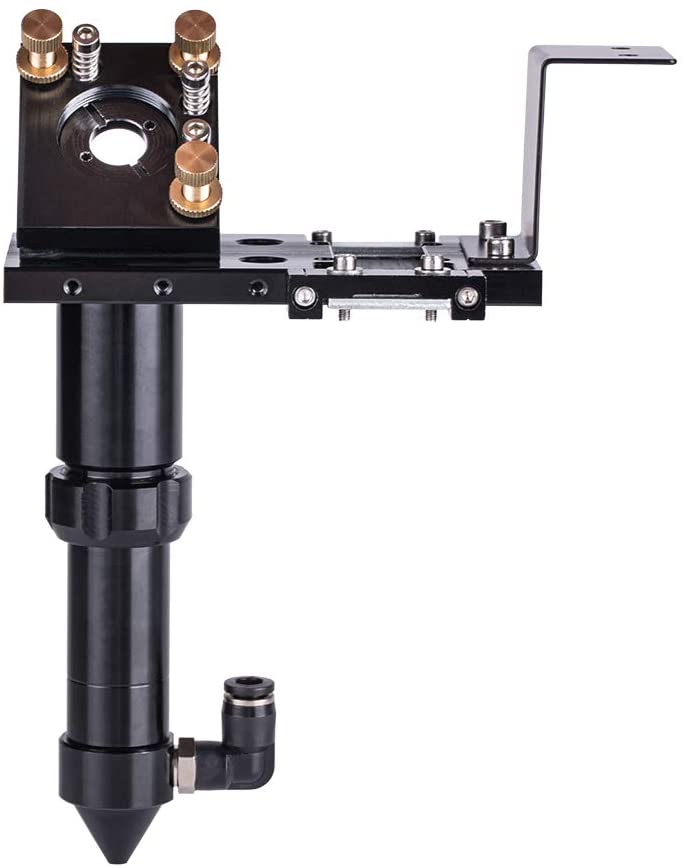

Yeah there is that also. Your tube lens or air assist tube would need to be short enough to accommodate the shorter FL.
They make laser heads with adjustable tubes like these.
Thanks, that should do the trick!
