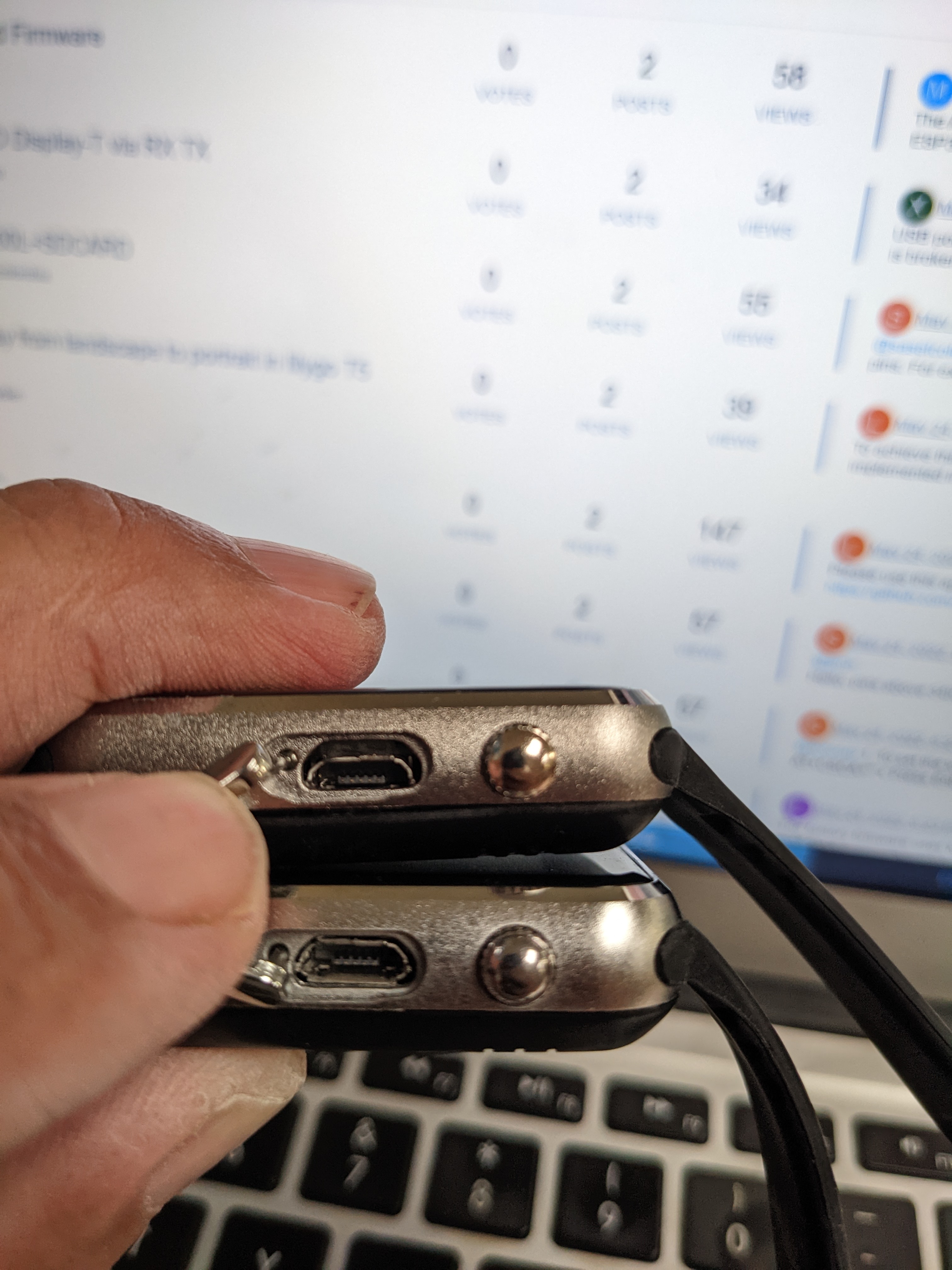

The brand new watch arrived from China already but unfortunately there seems to be an assembly issue. The USB connector does not line up well with the hole in the metal case. New watch on top, old(from 2020) on bottom.
What a bummer!
we’ll see how support operates.
