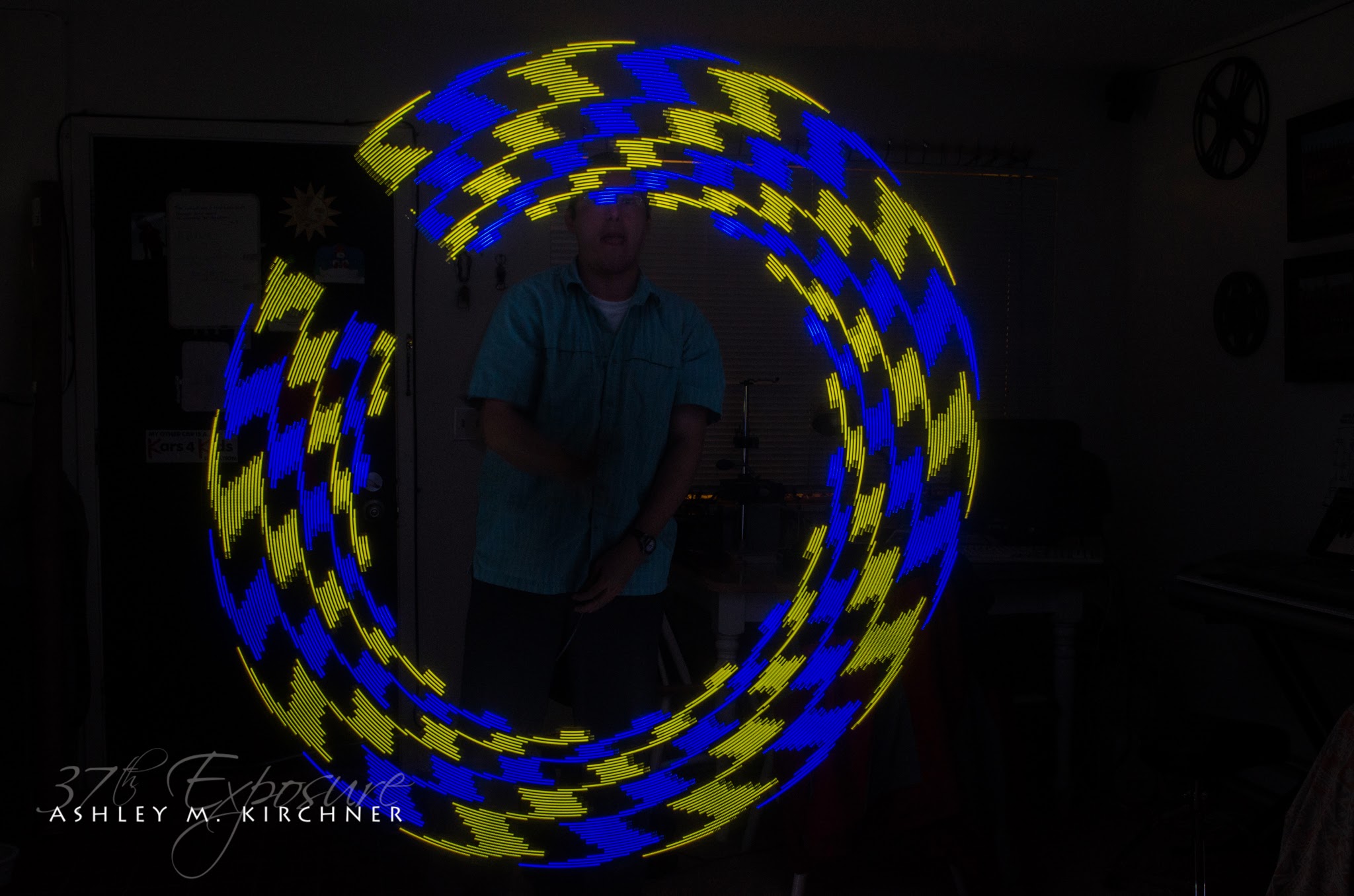

Taking picture isn't the issue.  Taking video on the other hand,
Taking picture isn’t the issue. Taking video on the other hand, doesn’t come out so well … (video is on YouTube: https://www.youtube.com/watch?v=H_293jVW4iM)
Actually, I just thought of something else that I’m doing in my code, kind of a “well DUH” moment … I’ll make some changes and try again this evening. I’m getting way too much light reflecting from all the snow outside coming into the house.
So - it looks like 1 frame of video is about 1/12th (give or take) of what your photos are. How long are the photo exposures for?
Video recorders/frames, sadly, don’t have much in the way of persistence of vision - if your photos are .5s, and you’re shooting at 30fps, the image in a photo’s going to be spread out over 15 frames :frowning:
I feel like what you want is some kind of video processing plugin that allows you to merge say, a frame and the previous 5-15 frames, to re-create the illusion of POV.
Awesome, well done.
Now I have seen your video, I think I know what your problem is: Turn off the image stabiliser.
It looks like the system is trying to track the most obvious object (the lights) and keeps trying to re-centre it. That’s why it jumps around. You can just see whoever is twirling moving too and they should not be.
Very nice pictures! :slight_smile:
