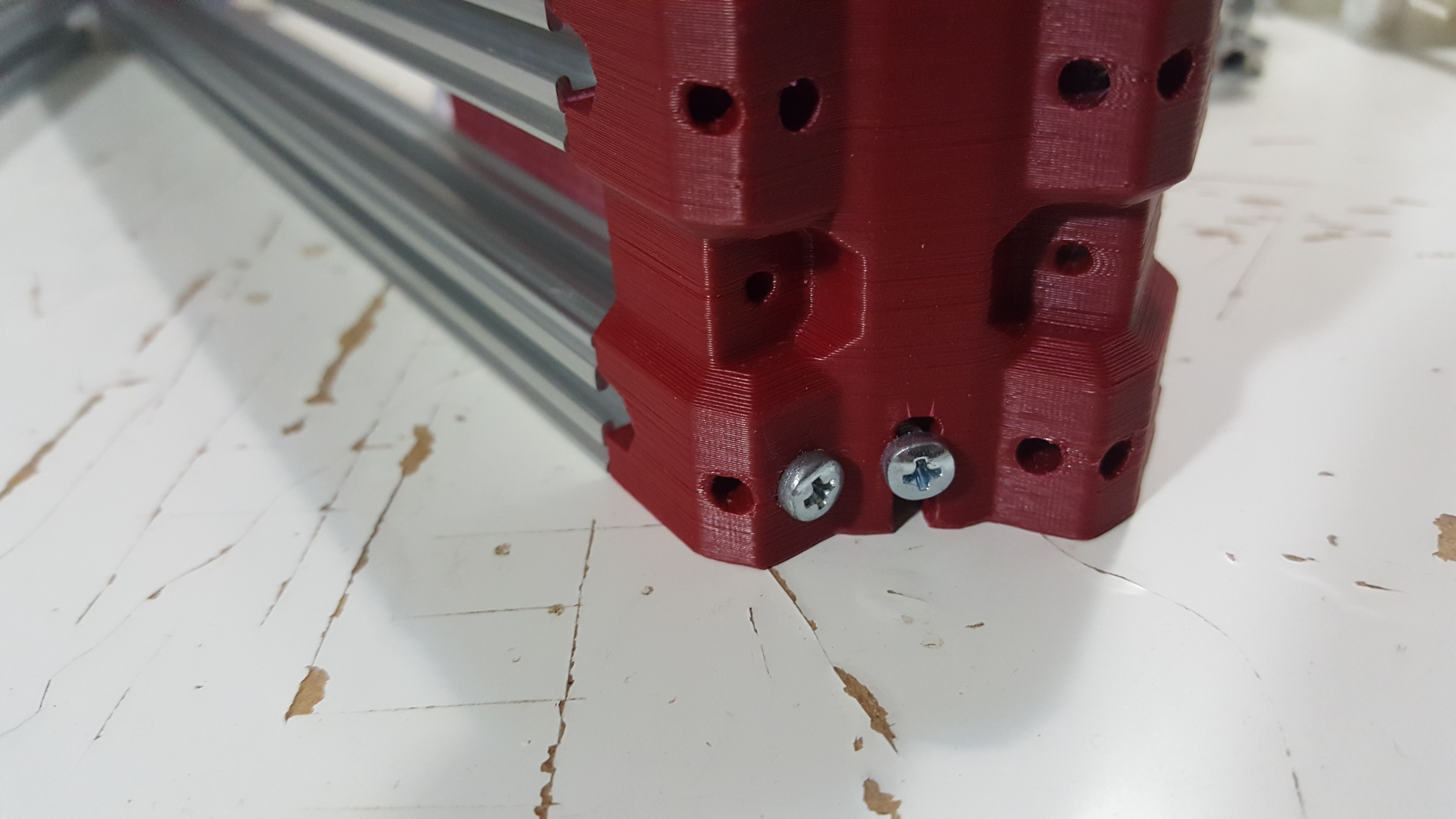

Tapped all the extrusions,
Tapped all the extrusions, really like how just a mild amount of pull snugs the extrusions up against the new lower corners. Took 3 days of learning about ABS and 2 different filament brands, but getting ‘good enough’ prints to at least get the other printer back up and running.
Atomic ABS, really like it any imperfections are the cantilevered failing bearings and pulleys on my clone i3. Micro Swiss and Atomic ABS are a great functioning combo. No supports needed unless its a reversed overhang that needs a starting point.
