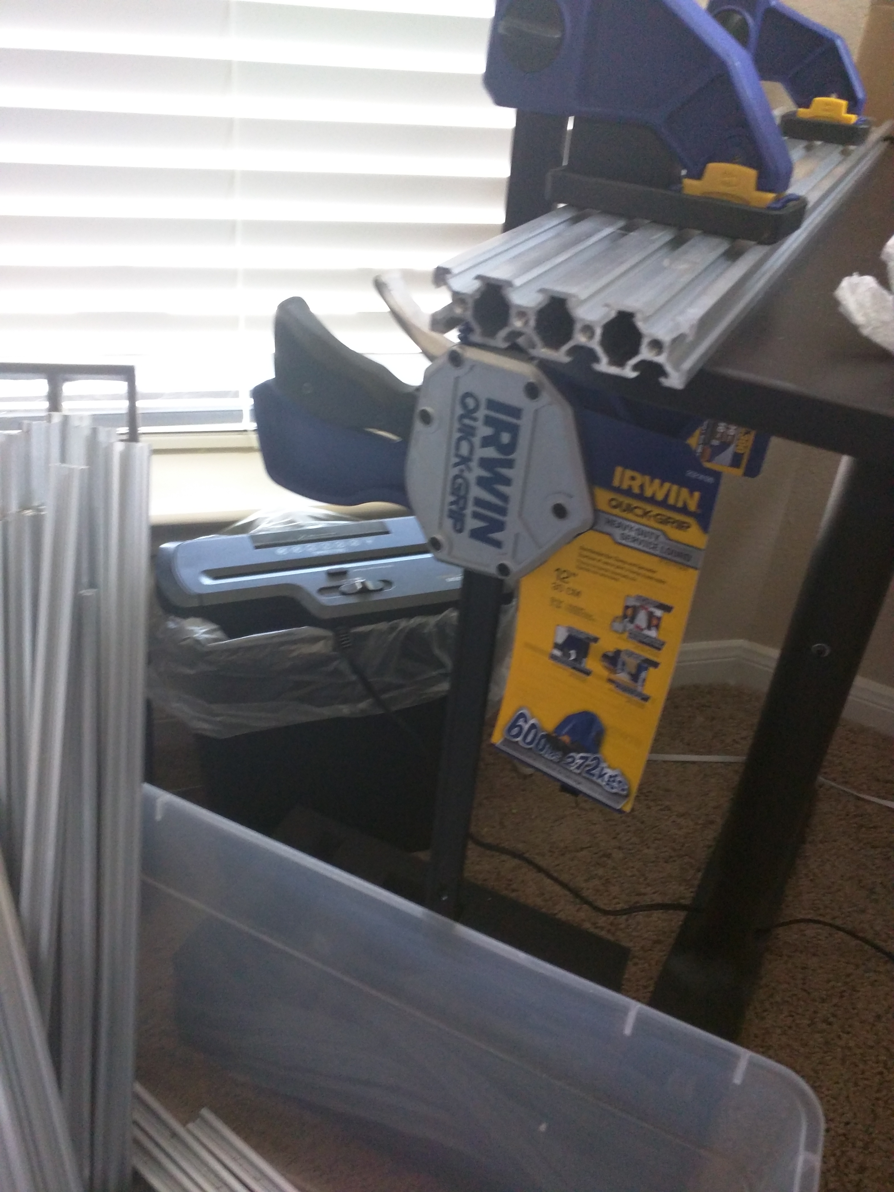

Tapping all these holes are hard work. The hole drilling is also very time consuming. Good thing the drill guide was very well designed. It would have taken much more time measuring.
I wish there is a service for cutting aluminum and tapping them so I just can get these predone. The fun part is the wiring up. Soon.
The hard holes are where the 10mm rods go through the frame. They are half on an internal rib. I recommend a drill press, and an end mill bit, or a hole saw. Bit walk is a bear with a standard 1/2" tapered tip bit.
Yeah, it looks like I need to finally get my own drill press. My only problem is I have no work bench in the garage for the drill press. Now I have to get recommendations for a work bench in the garage.
Make your workbench. Two sheets of ply and a top sheet of mdf and a tube of glue. You will be able to afford a nice end vice and still come out less than half the cost of that ‘workbench’.
As to tapping holes, don’t bother, just buy self-tapping bolts. I tapped about five holes in my aluminium extrusion life, then went self-tapping and have never had a problem in the hundreds and hundreds of ends I have tapped, since.
Maybee you are already Done, but I recommend to dip the threading pin in ethanol before tapping. This works perfect When tapping with a metal tool in aluminium . I did the tappering manualy in the beginning but then I started using a screwdriver and drilled very slowly . This together with the ethanol made it work very smooth !
