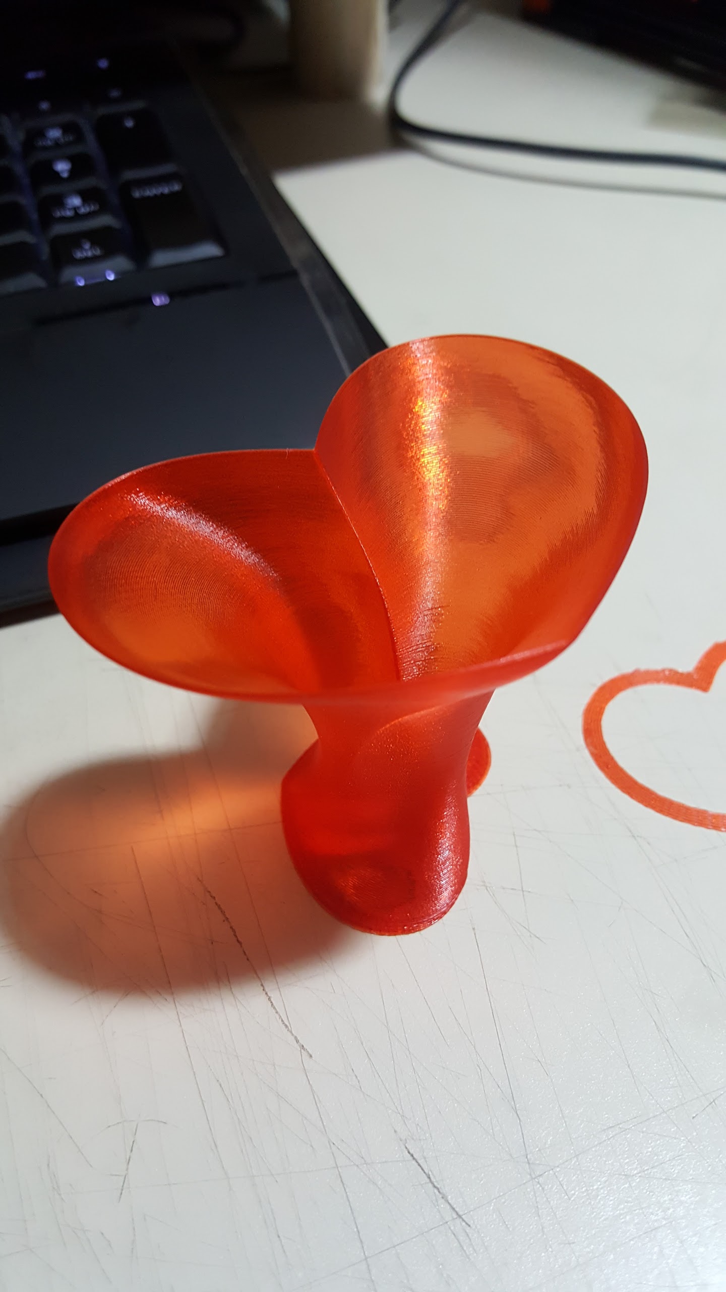

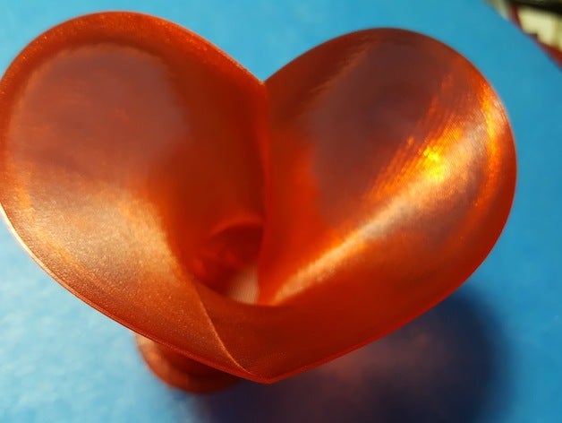

Taulman3D IN-PLA… best stuff I have used yet, simply amazing consistency of extrusion. .2 layer, 25mm/sec actual speed (vase mode). Prints hot at 210-ish. Used 60c on the bed for the small print (one calibration object lifted slightly with no bed heating, Taulman says 70c for big prints). The first test calibration did overhangs to 62 degrees and perfect bridges.
Images of 3rd print, small vase, absolutely perfect not one defect from the consistency of extrusion. MiltyKoss is running nicely as well finally after the whole ‘melted motor mounts’ debacle.

Looks really good!
can you upload stl file of this vase?
@Peter_Greno sure…
