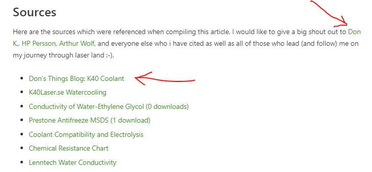

@donkjr If you look at the end of the article, his references are posted and your blog is #1!
@HalfNormal My bad … I am used to information being linked as it is used, especially quotes.

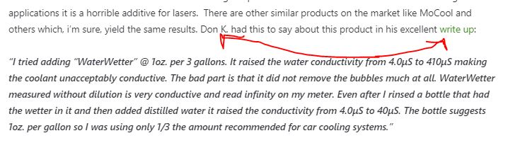

@donkjr i didn’t see the above quote in my article but i did make sure to cite you multiple times where i used your material. its great work and i point people to your site often
sorry it wasn’t clear.
and, for transparency, i pulled the rss feed of your blog and made a category just for you: https://www.lasergods.com/category/blogs/dons-things-blog/. if this is something you had rather me not do by all means let me know and i will correct it.
ah i see, the rv antifreeze info above was not the quote you were referring to. if its okay i’d like to append the rv antifreeze section with the above info, with credit of course.
