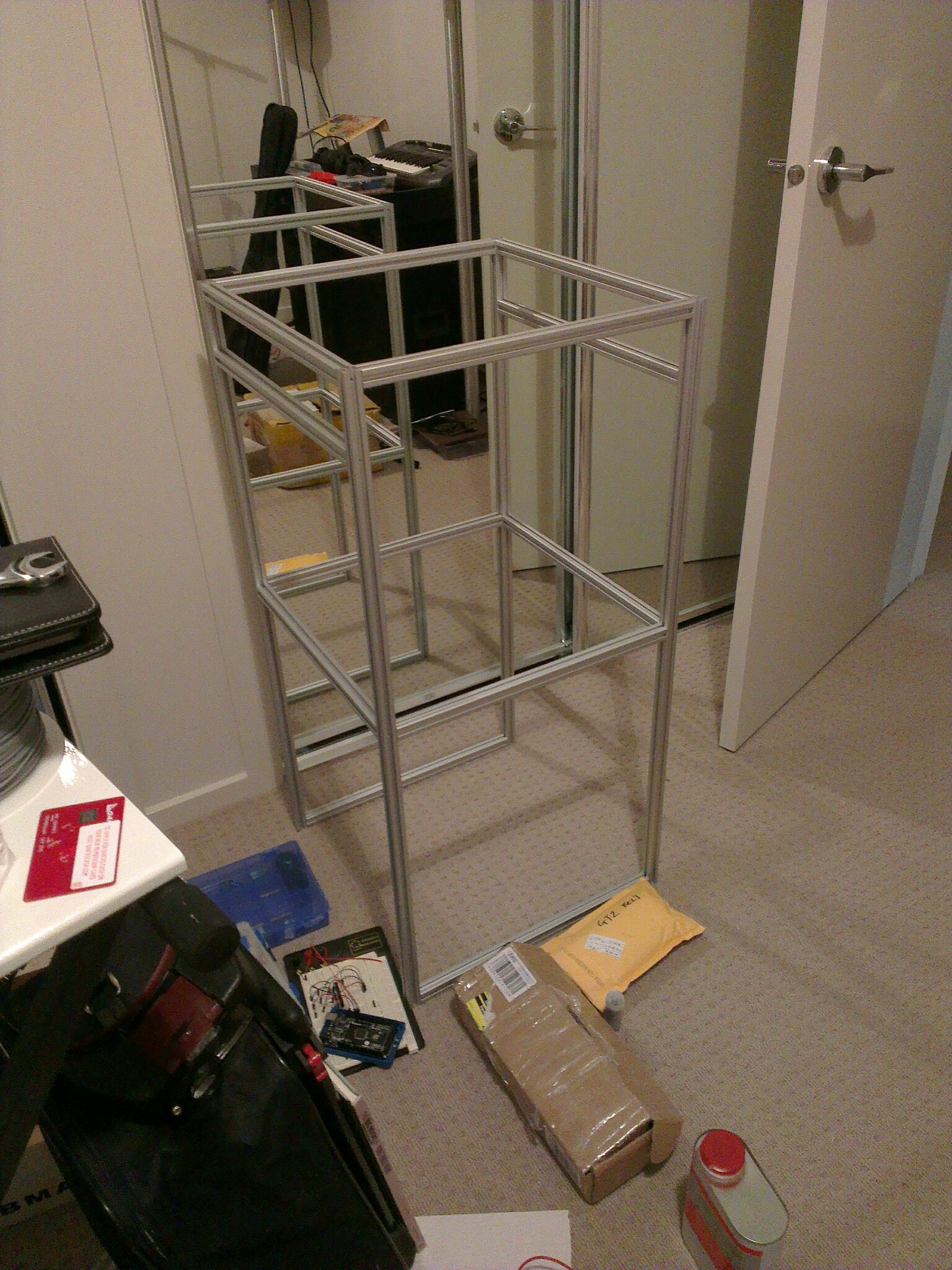

Too heavy is right! I needed to upgrade to stronger stepper drivers - may even need to get large off-board drivers, I have leant a lot through doing this, I would change a fee things if I were to make it again - the build volume is about 300x280x650 - I would probably beef up the frame at the very least!

You might still fight inertial resonance from the weight difference of aluminum to plastic. But looks like you could add some lightening pockets to help. The added inertia will cause ringing on fast direction changes. Also perhaps some angled braces or cables would help the frame.

Lightening pockets I do plan on working on, even if its just some drilled holes - those parts ain’t gonna break before the belts do! Some sort of cross bracing will be good but I realized I have to have the front open (or open-able) to remove prints! I will think about it though, I want to enclose it so perhaps I can design the enclosure to also brace it
