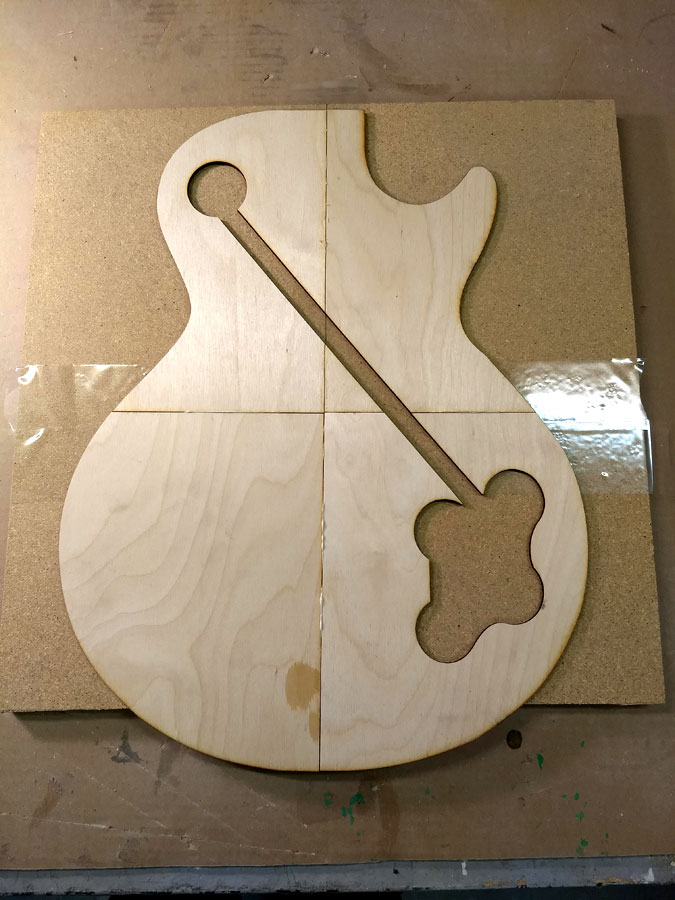

For those interested in making something larger…I split the template into 4 and used wood glue in the center section and CA at the ends to initially hold it together.
Well done :slight_smile:
