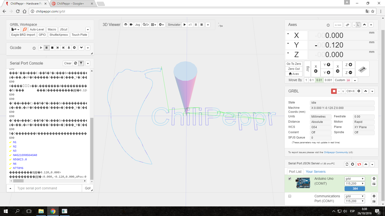

tengo un problema , el fondo me sale en negro y no corre grbl

I started seeing a solid black 3d view on both Firefox and Chrome, on multiple machines using the grbl workspace. It started yesterday. I was updating drivers, clearing caches, etc until I noticed it was happening everywhere. Changes?
Consistently seeing “Uncaught ReferenceError: THREE is not defined(…)” in the console. Not sure if that’s related.
