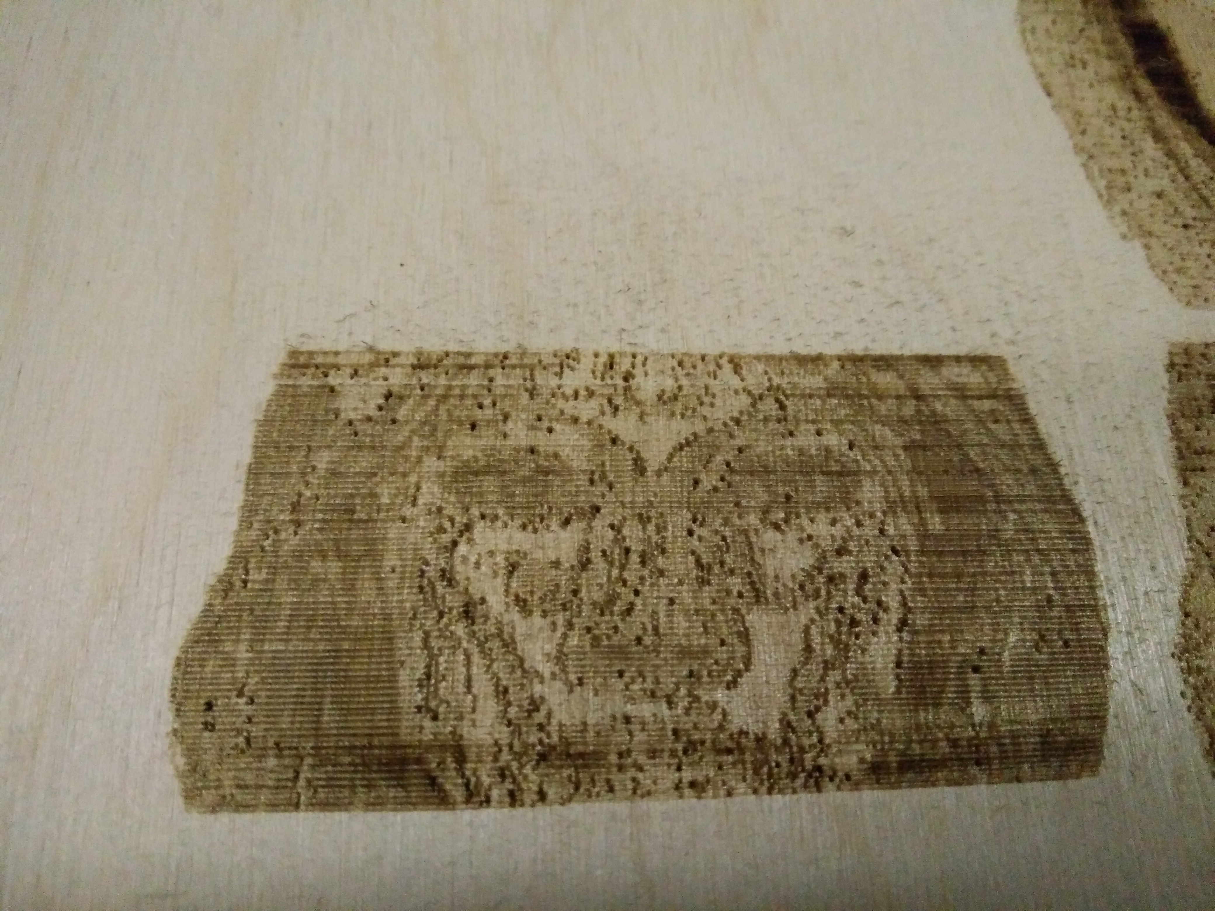

Test results. Not looking good. +Peter van der Walt @Ariel_Yahni_UniKpty @NathanielStenzel
; GCODE generated by Laserweb
; Firmware: Marlin 1.0.0
; Laser Min: 15%
; Laser Max: 24%
; Black Speed: 1140mm/min
; White Speed: 5100mm/min
; Laser Spot Size 0.19mm
; Laser Feedrate 3000mm/min
