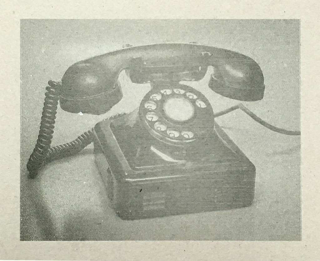

Tested the latest Emblaser 2 electronics with Laserweb 3 today. We engraved a photo onto some scrap cardboard and were very happy with the results and workflow.
Well done to everyone involved with LW (especially that guy called Peter).
Tech Info:
NDB7A75 diode
100% power = 3.0A
0.15 kerf size
0-50% power range
60mm/s white
40mm/sec black
Stable Master.
We’re testing the electronics a little conservatively at the moment. Should be able to crank it up to full power and speed soon.
Also want to discuss the ability to engrave at 45 degrees at some point. That will make a noticeable improvement to the engraving quality.

@Domenic_Di_Giorgio1 … was this exact focal length of your laser or slightly out of focus
The focus was slightly out but I can’t quote the amount as we didn’t record that setting.
@Domenic_DiGiorgio cool thanks it gives me a starting point to test
@Alex_Krause Cardboard is a good material for testing engraving. It’s cheap and easy to find. You just need to be careful with your power settings as it can easily ignite.
@Domenic_DiGiorgio there seems to be a power level on cardboard where it turns white durring the engrave
@Alex_Krause yes it does but that above I don’t think is regular cardboard. I believe is similar to what I used the other day
@Alex_Krause yes, it seems the laser bleaches some color out of the cardboard. I have a good example of it but not sure how to post another pic to this post.
@Ariel_Yahni_UniKpty It was from an old box we had laying around. It does look a little lighter than other cardboard boxes we have here. Looking closely at it shows a lot of imperfections which could indicate it is a partially recycled material.

Cool. Here is another engraving that shows just how much bleaching happens. http://imgur.com/a/InZGT
@Domenic_Di_Giorgio1 that’s just amazing. Did you use the same settings as before?
@Ariel_Yahni_UniKpty On this one the settings were a little different.

I actually prefer the pervious settings as they have better contrast.
