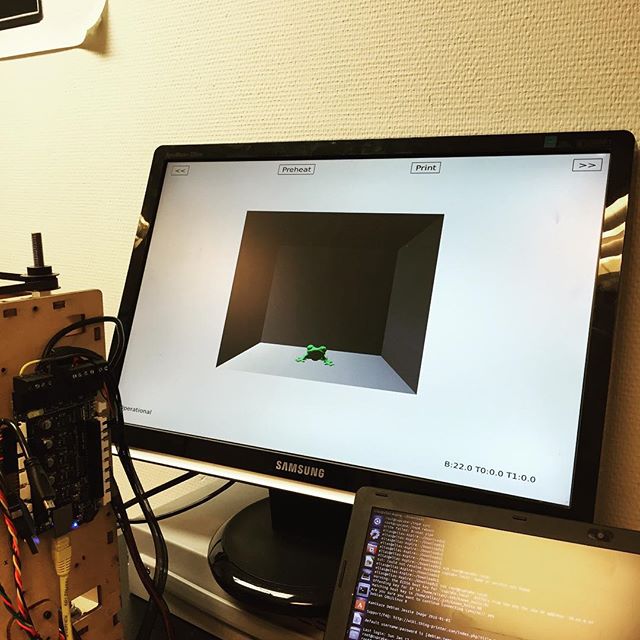

Tested Toggle with a different resolution, took me 15 minutes to configure.
Tested Toggle with a different resolution, took me 15 minutes to configure. If anyone has a resolution they want packaged in the deb/repo, just make a pull request.
