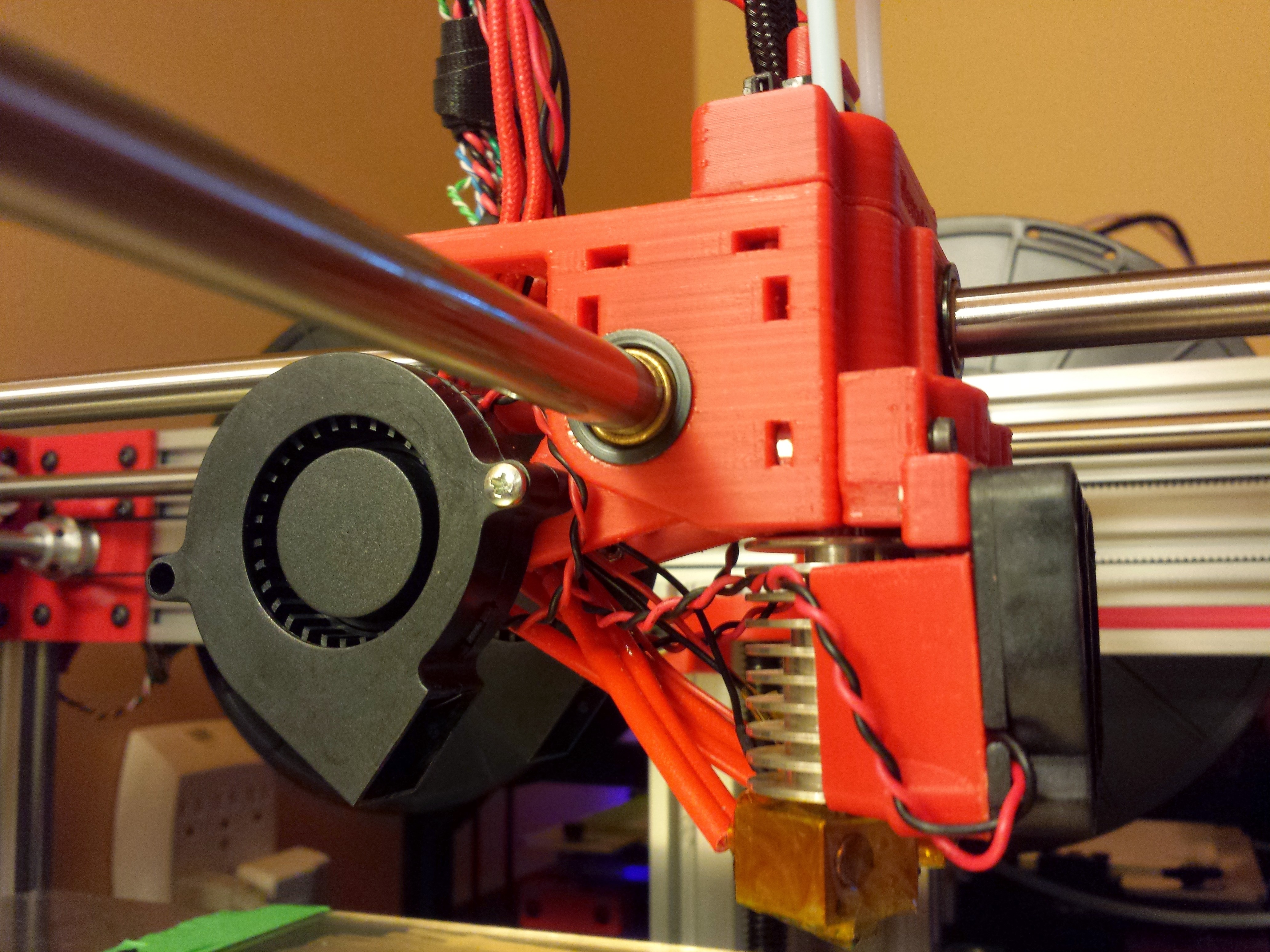

Testing 50x50x15mm blower fan as a replacement of my current axial fan system on #HercuLien. So far I like it much more. Way more airflow, and higher velocity. Time to build a better mount and design a small directed duct.

@Wayne_Friedt I agree. But when ducting an axial fan around too many curves the static pressure drop really kills the cfm. I am hoping the centrifugal fan handles this better.

What about noise? I tried once some time ago and mine was awfully noisy
@Jeremie_Francois mine are silent other than the sound of rushing air… Which is a welcome sound for high speed PLA printing.
