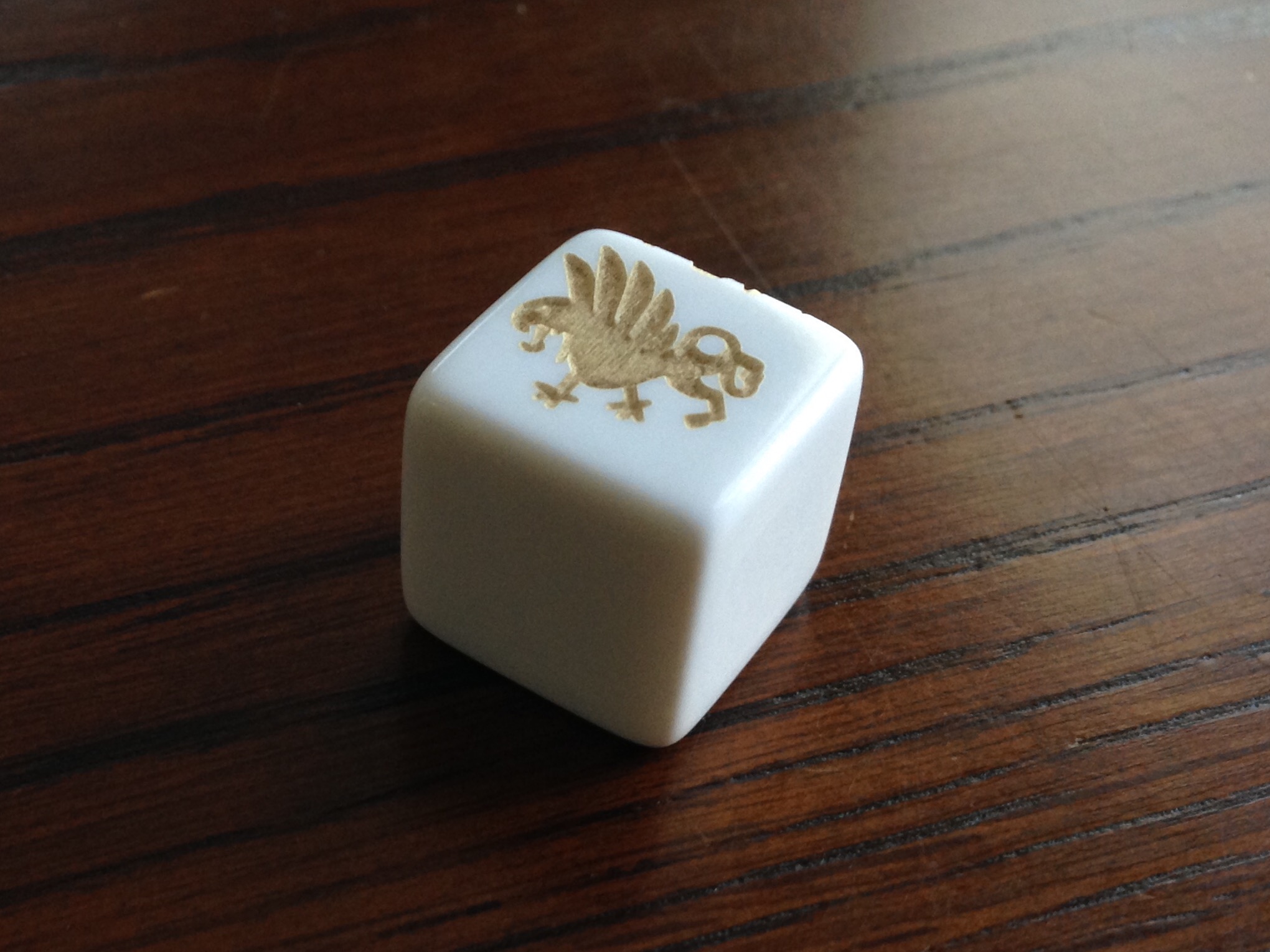

Testing laser-etching dice. Works quite well, although scale and alignment is a bit trial-and-error.
Testing laser-etching dice. Works quite well, although scale and alignment is a bit trial-and-error. Would probably be easier if I had my cutting area ruled and if I had a laser pointer to show placement better.

Heh, I actually used the clamp the K40 comes with to hold the die in place (against a piece of wood to move it down the Y a bit). I’m probably the only one who’s actually used that terrible thing. :wink:

In regards to aligning your jobs, simplest method (in my opinion) is to place some plywood (or cheap wood) & create cutting jigs where you place your objects in pre-cut “slots”. As an example, assuming these dice are 20mm cubed, then I would cut a 20mm square in some ply at set co-ordinates, & then every time I go to etch one of these I would use that jig. As the dice have rounded corners you may have to use a few thicknesses of ply to get higher than the corners or aligning will not be so straight (you want to have it on the nice straight edges).
