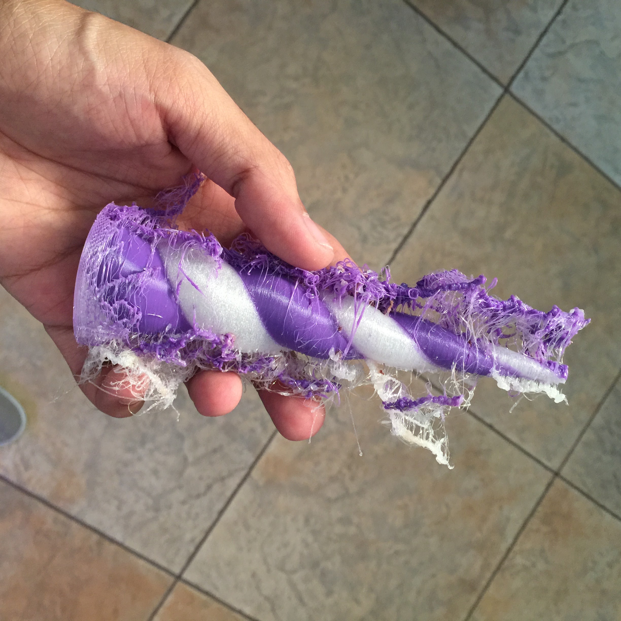

Testing out dual extrusion with two-color ninjaflex using simplify3D. Trying the ooze shield feature.
Testing out dual extrusion with two-color ninjaflex using simplify3D. Trying the ooze shield feature. Printed on a flashforge creator pro.
Was this the expected behavior of the ooze shield?
@Marcus_Guin_Klutmann , no - the ooze shield is meant to be a 1-layer width shield around the edge of the part.
@Marcus_Guin_Klutmann Yea @ThantiK is correct. Ooze shield works best for hard plastics. I wouldn’t recommend trying this with TPE filament. Merely preliminary testing here.

It’s for a cosplay wearable project. Mostly experimenting with dual extruding ninjaflex but it’ll be less pokey hazardous.
