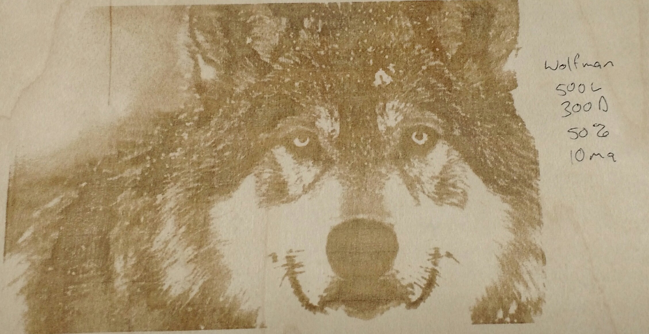

Testing out some firmware this time a more controlled test.
Testing out some firmware this time a more controlled test. Exact same gcode same material (maple ply) and grain directionality. Left : @Wolfmanjm ​ firmware ; Right : Master firmware
Is it me or there is much more detail on the fur on the left one?
Thanks for running this test Alex. We have it on our list but haven’t gotten to it yet.
The differences are very subtle but there looks to be slightly more detail in the fur on the ‘wolfram’ version as Ariel mentions.
The horizontal artefacts are also more visible on the ‘wolfram’ engraving as well. Have you located whether this is a software or hardware issue yet?
I suspect the acceleration-attenuation will be more noticeable with vector cutting around sharp corners.
Can the attenuation value be set in the firmware? If so, what values are you using?
well it looks at least as good as the master branch one, so I’ll build the edge version of this for distribution. At least it fixed the improper acceleration compensation. So the edge build on github nopw has this new fix. I recommend using the firmware-cnc.bin build but either will work for you guys. just remember the cnc build uses $H to home like GRBL does.
