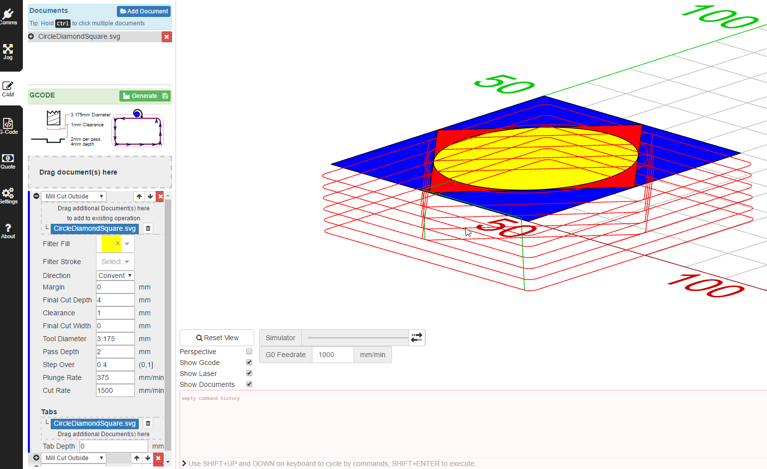

Testing out the LW4 CNC side of things. It seems that the circle portion of this test isn’t showing the depth configured.
When I look at the GCode I see that for the circle it retracts to the 1mm safe distance and then returns to Z0 for both passes instead of Z-2 and Z-4 as expected. However it seemed to work for the diamond and the square at 8mm and 12mm respectively.
Generated GCode here: https://www.dropbox.com/s/14ktd5jtc47usek/gcode.gcode?dl=0

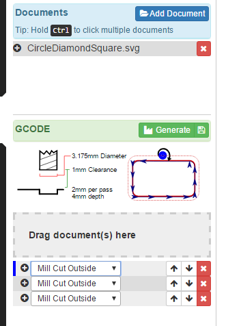

I have 3 separate operations using the filter color option as described by @Todd_Fleming All 3 colors are different paths in the same SVG and each was dragged in as the full file and the color filter applied. I’m trying to understand why it worked for the red and blue but not the yellow.

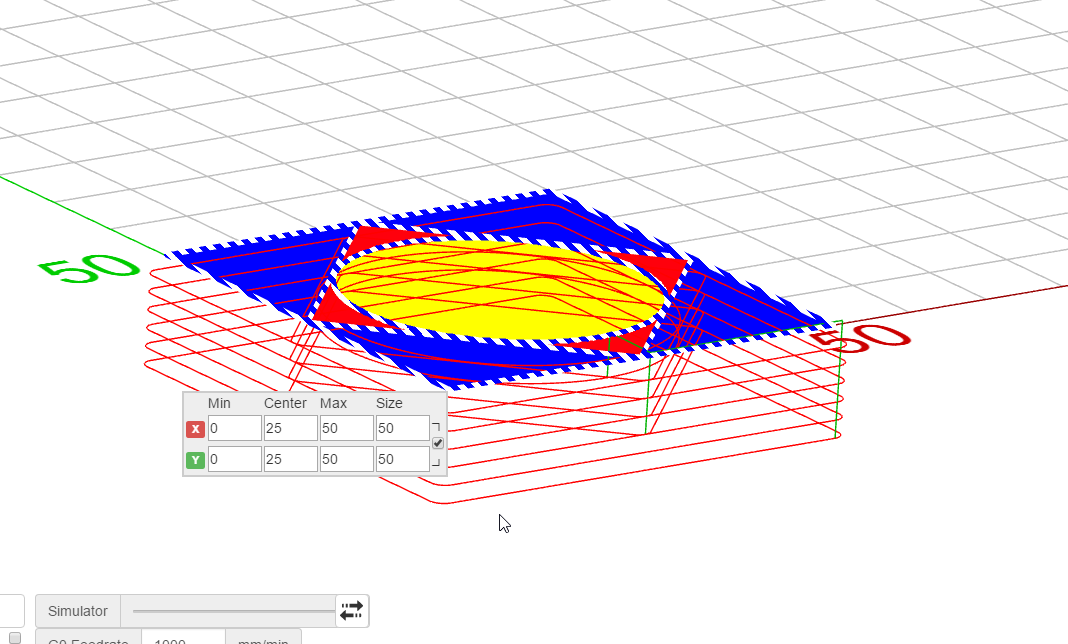

I wonder if there are not enough intersecting points on the diamond and square for it to union. Let me try the same thing but bring the circle in a little bit so there is little to no intersection and see what that does.
Actually putting just a little gap between the edges of the circle and diamond solved it. That’s interesting to keep in mind that it will union shapes like that and I guess it makes sense, it was just odd that it was showing the correct operation but omitting setting the Z-depth correctly.

There’s a bug somewhere; it shouldn’t have been able to produce Z0 with the settings in your screenshot.

You can see in the original g-code file that I shared above though that I wasn’t crazy
Yep; you’re not crazy. That gcode definitely shows a bug.
