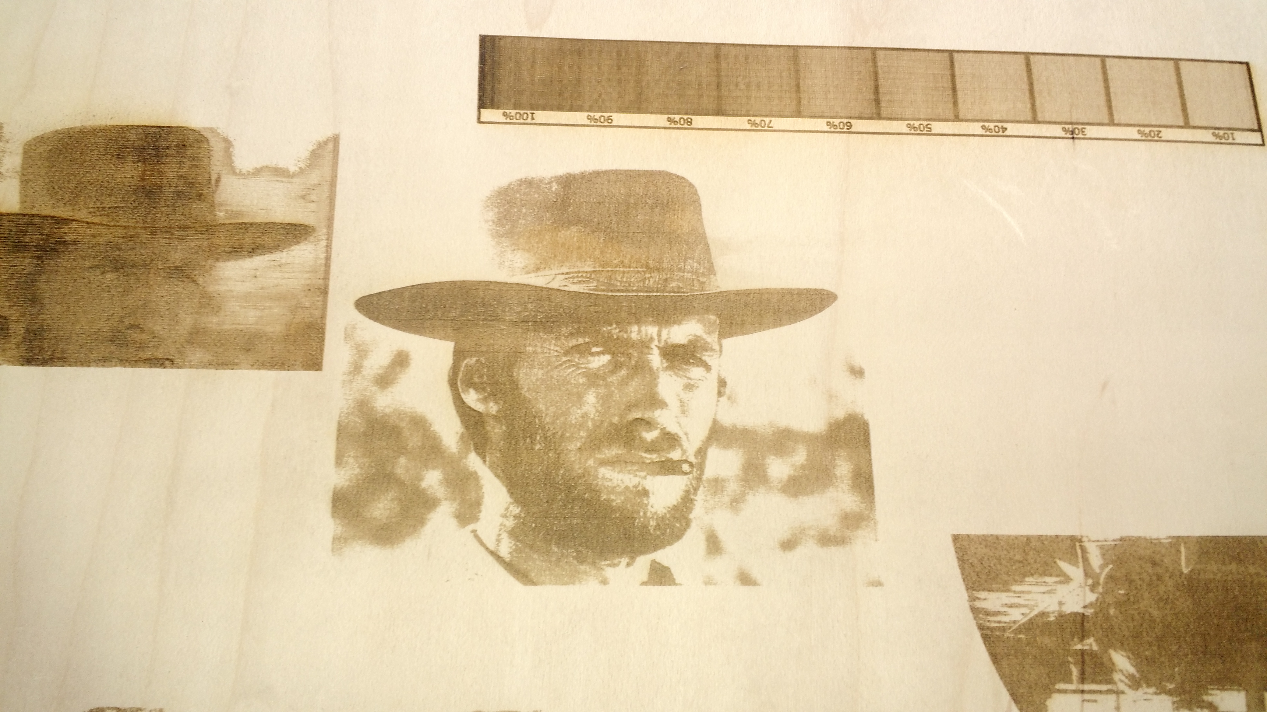

Testing out @Wolfmanjm ’s newest smoothie edge firmware build… looks pretty good to me so far… will continue testing and reporting back any hiccups I encounter along the way

Wow, that is spectacular results Alex. Is that on ply?
@Yuusuf_Sallahuddin_Y yes I use maple ply to do most my image rasters… I find it gives me the contrast that I’m looking for
And it smells pretty decent when you engrave/cut it
@Alex_Krause That could be the issue I am having getting contrasts nice. I am just using some cheap ply (I don’t even know what it is). Might have to look around for some different variations locally & see what I can find.
Cheap ply defenetly burns the top layer to fast
Baltic birch (finish grade) is a good choice of plywood as well… don’t get it confused with regular birch ply (construction grade) there is a huge difference in it.
