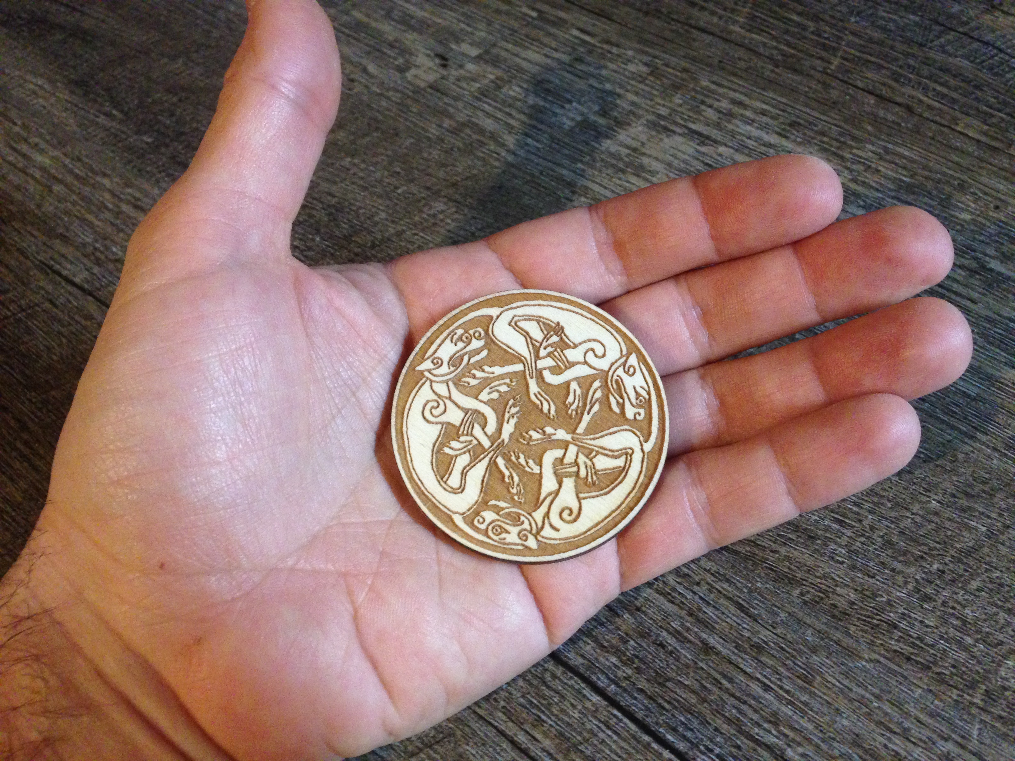

Testing some cutting power/speed settings last night. At 6mA (which I used at 320mm/s for the engrave), 9mm/s cut through this 3mm plywood, at 10mm/s it didn’t quite make it.
Very nice piece. The engrave is quite a nice contrast to the non-engraved area.
Nice job! Good detail
