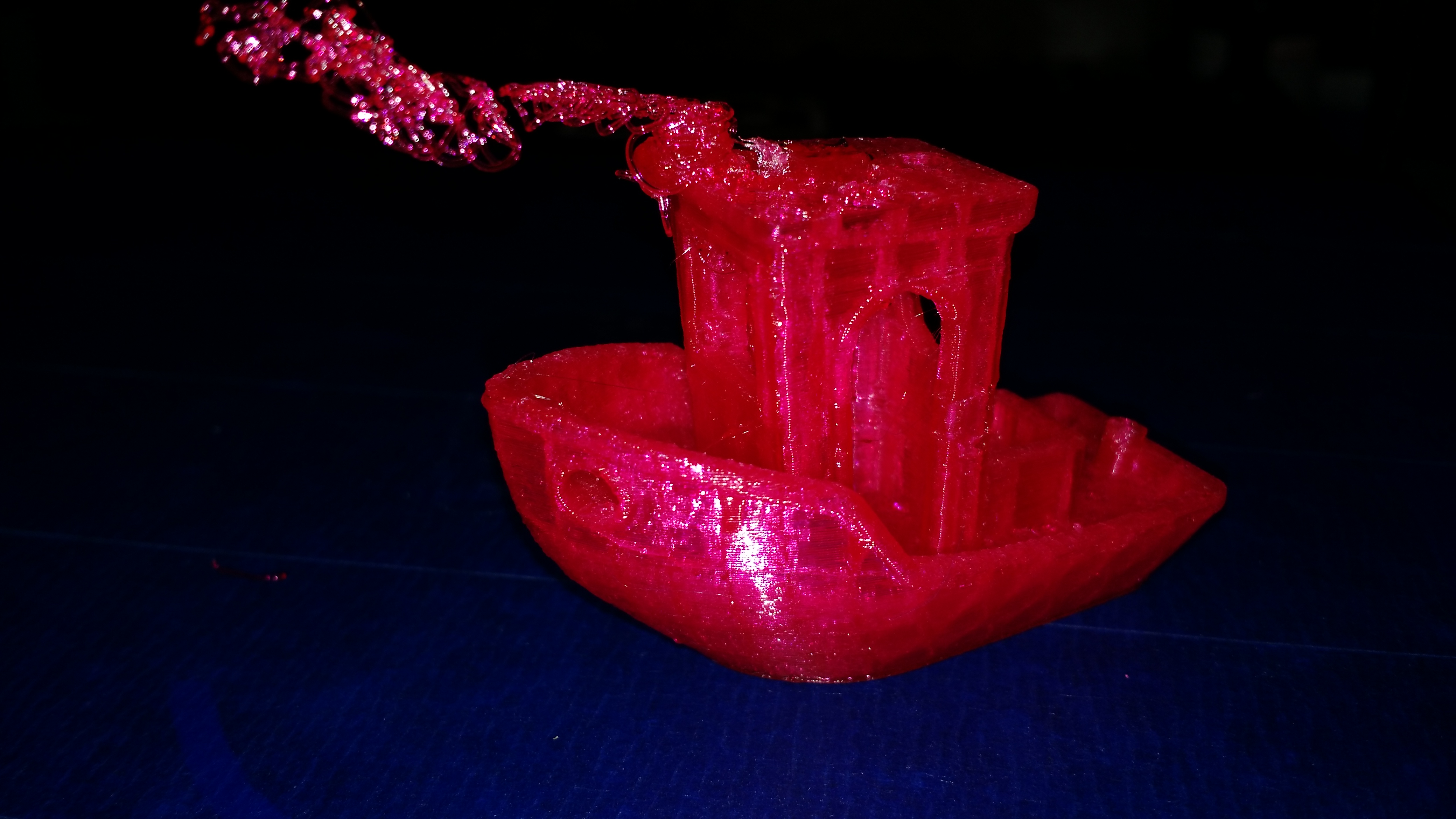

Thank you all for the help getting PetG to stick to the bed… Now I need to figure out how to keep the filament to from getting stuck on my nozzle and ruining the print when a glob adhears to a layer causing a print failure

On the plus side 1st ever benchy with actual smoke from the chimney.

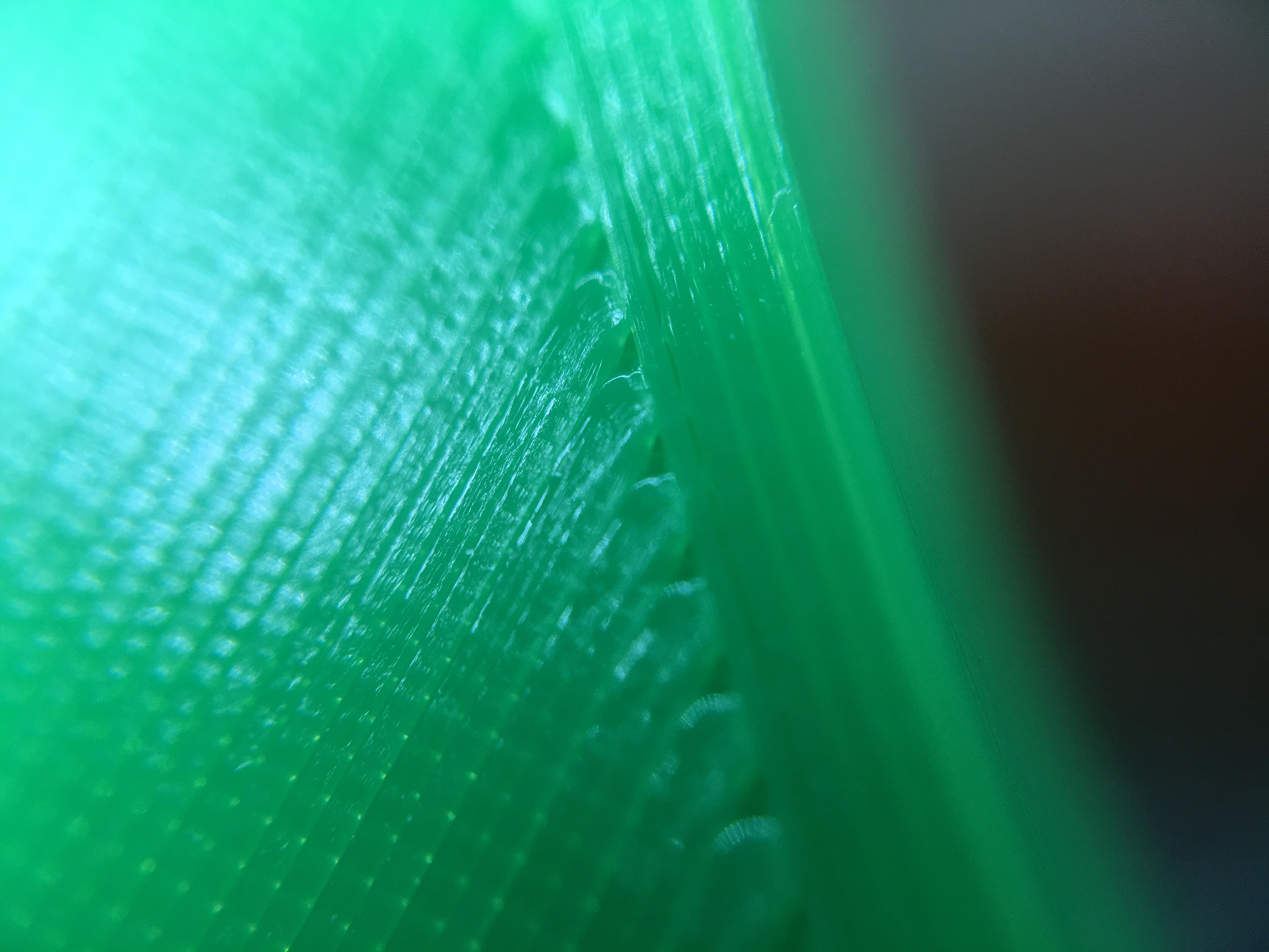

Dont do singlewall test for extrusion. Do solid infill/toplayertrst. Toplayer should look like this:
