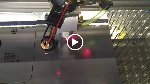

PS. Great results cutting brushed steel on the K40

@Mircea_Russu Thanks for linking the exact material. You should not call this “steel”, this is missleading. It is normal Acrylic with a special paint/surface.
