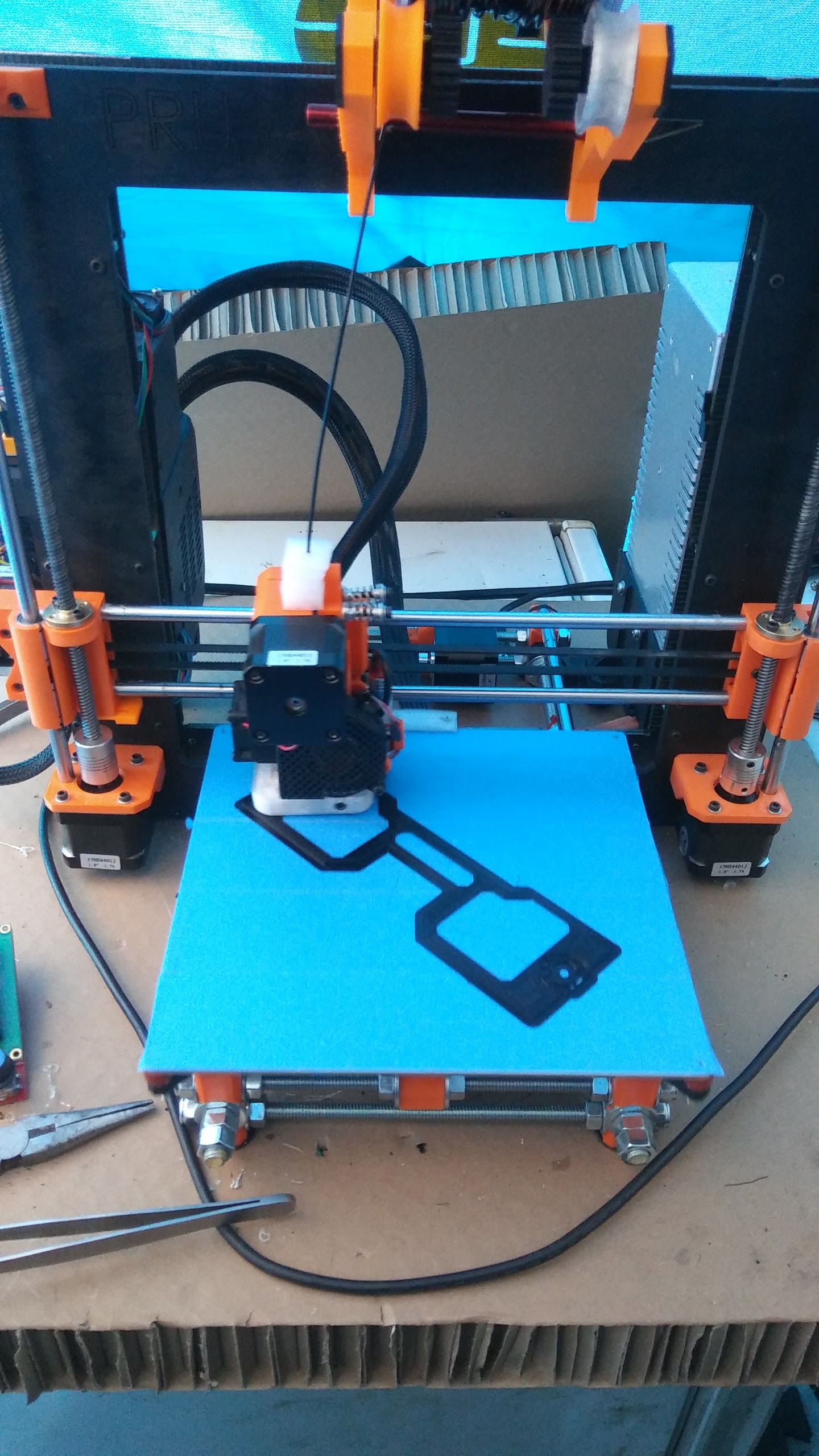

Great clone. :wink: Are you using any LCD with upgrade to TMC2130?
Power
@Matus_Kostik yes I was using the Reprap_ discount_smart_controller but it was damaged so I’m using the Full_graphic both work the same. I soldered to these pins and its the same on either controller. You can see the TMC2130s above and this is how I had them solder originally when I was not using the protectors.https://lh3.googleusercontent.com/24wQr0PRikJn_DtkjPzWF23VTN2s08zLOWDyWoQYJ0ffY566SyP7klZMZ8JoH5WGG_O1FVRYHw
@EMEKA_ABINALA I’m running 24v to the Ramps 1.4 and with D1 diode removed I use a buck converter to step down to 12.5v to power the Mega 2560 through the power jack.https://lh3.googleusercontent.com/yejMdZ5FN1VfUhs-SjaojYAFVu70QuMacbDioCIv_iAqsjPjgyjFT1mBsxWzsfpHeOxMtcjyMQ
Here is the finished print. 230c E0 90c HB @50mm print speed, 0.2 layer, with 1.8 mm retractions, and in 1.75mm Solid Black Petg from esun.https://lh3.googleusercontent.com/VDlgZn5DAC2Dm4Z8SiBYj2DqGfTTHRQw9LLceJ6uUGO797yyMX_MdLEvzFDgGl3WkW2LI2Jyjg
