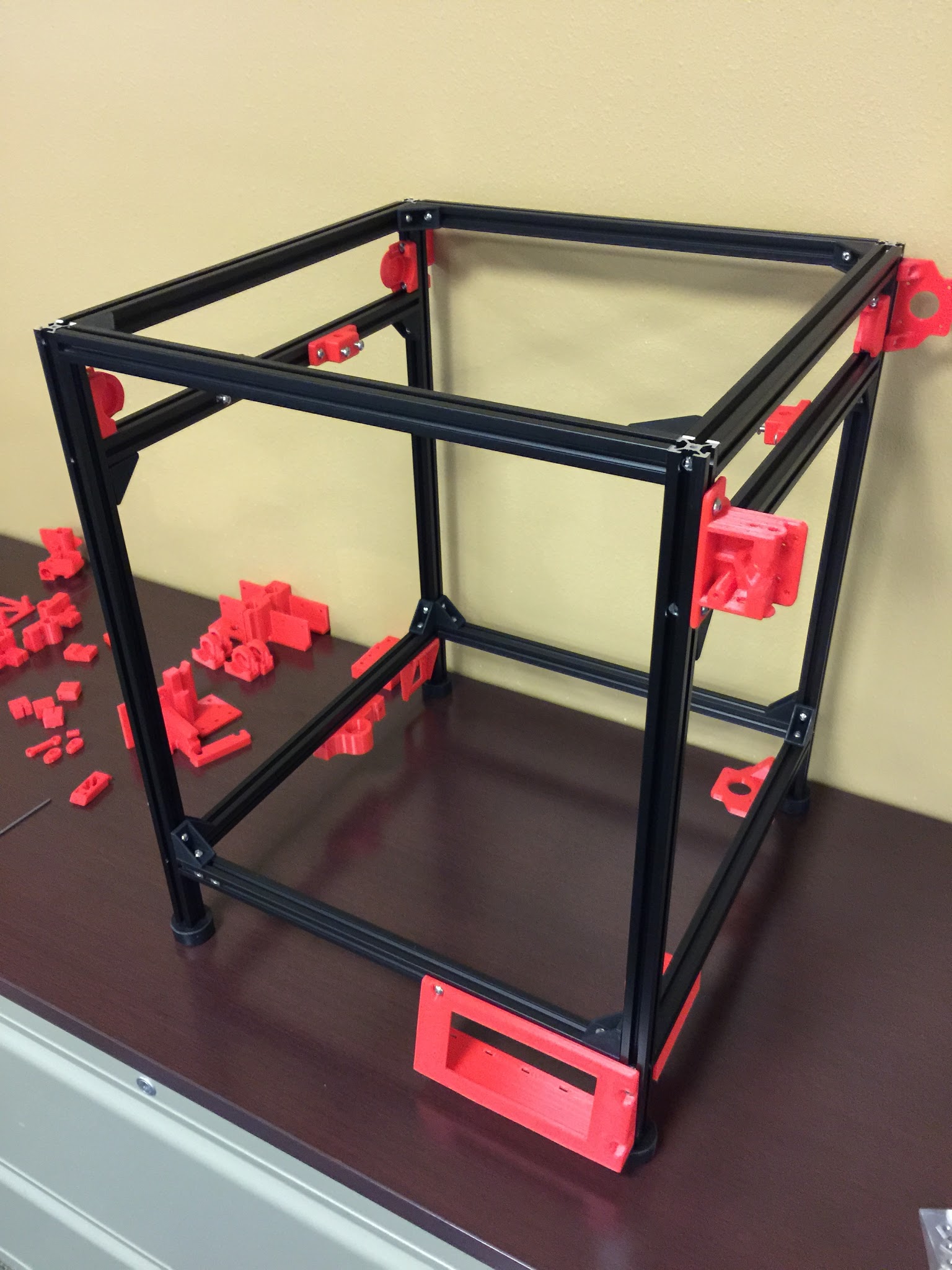

Thanks @Gus_Montoya for posting those pictures of your progress! It finally got me motivated to put my Eustathios Spider V2 together. Can’t wait to work on this some more tomorrow.
@bcrazycramer Me motivating? I guess theirs always a first for everything LOL. But I’m glad your moving along. I recommend you install all plastic parts first. And I mean everything. Thus far I’ve had to disassemble 6 times because I didn’t forsee additional screw nuts needed into the frame. And what ever you do DON’T LUBRICATE THE BRONZE BEARINGS. And doin’t force the bushings into the plastic. They are suppose to easily press in with almost zero effort. This is causing me serious set back and $$$.Your build is looking good
Love to see so many coming together. I must admit black and red is a good looking color scheme, but maybe I am biased
